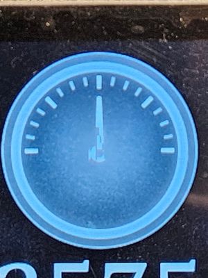

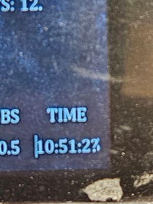

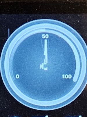

I'm getting the following artifacts in the display and as of today, haven't tracked down the cause. I've adjusted DSI clock timings, LTDC clock timings, and SRAM timings. Caching is configured as off for the SRAM via MPU. Any ideas?

I would start by inspecting the frame buffer, from the static images this doesn't look to be a display timing issue.

Debugging the SDRAM on the FMC bus shows that it is functional.  Writting and reading to it passes.
Moving the framebuffer to another memory address had no effect. I did, however, have to move the framebuffer on the same SDRAM, the MCU doesn't have enough RAM for the framebuffer to be located on the die.
Same fragmentation artifacts appearing.

Render time is looking like 40ms. That seems slow to me.

I have the same issue but it is not permanent, it comes once in a while... In my case I have verified that when this happen it's the frame buffer that is corrupt.
My setup: custom board, STM32H743, external QUADSPI flash (memory mapped mode), single framebuffer internal RAM_D1, LTDC, DMA2D RGB888 Memory to Memory transfer mode.

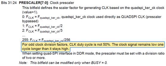

I managed to solve my issue.
I had my QUADSPI clock prescaler at 1 (25MHz QSPI CLK).
Changing this to 0 (50MHz QSPI CLK) or 2 (16.6MHz QSPI CLK) then my QUDSPI data reads got flawless.
From the STM32H743 reference manual:
