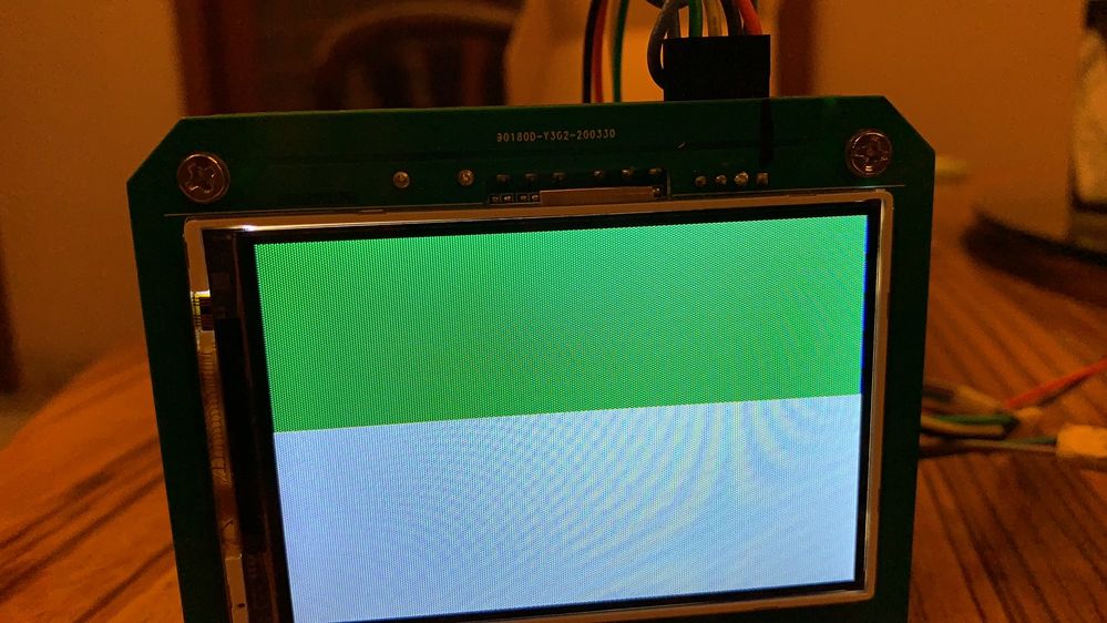

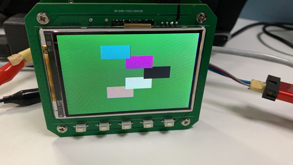

I used partial frame buffer + FSMC.A strange thing happened to me.Any monochrome can fill an entire screen.But if you use more than one color, GFX will no longer fill when it encounters another color.
Did I do something wrong?

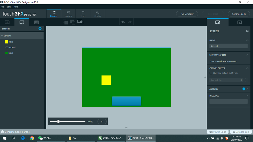

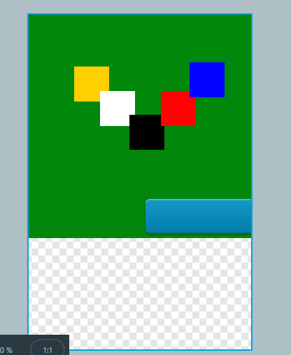

Now there's a new problem. The image seems to be stretched.
And only half of the images in the designer are displayed.

And the other thing that's odd about it is, whether it's portrait or landscape.The screen can only display the first half of the canvas in the designer.Both the screen and GFX have 480 x 320 resolution.
