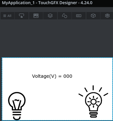

I am using TouchGFX 4.24.0(The newest version). It does not seem to generate the newest version of code for STM IDE to use. I think this causing problems when I need to make changes between the script and the gui. Is there a way to change what version of code is generated?
I have no examples to show, other than it prompts me to "Migrate" to a newer version when I go to the IDE. When I start to make changes to the original gui it obliterates my code, Wigits go missing, screen flickers. I am using the board STM32H735G-DK.

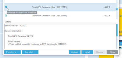

TouchGFX is made of 3 parts:
- TouchGFX Engine
- TouchGFX Generator
- TouchGFX Designer

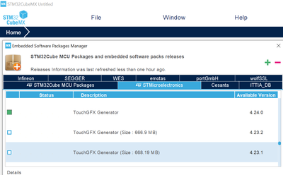

You have to make sure you have the latest version of TouchGFX Generator.

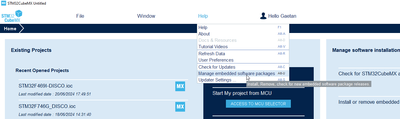

To do so, open STM32CubeMX, then click "Help" => "Manage embedded software packages":

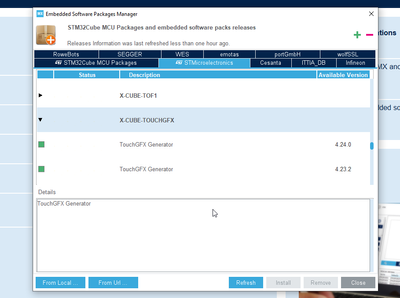

Then, go to "STMicroelectronics", scroll at the bottom to find "X-CUBE-TOUCHGFX" and expand the list. This is what I see with the latest TouchGFX Generator:
If you do not see "TouchGFX Generator 4.24" in green (on the left):
Then you have to install it.
Click on "Refresh" and select the TouchGFX Generator you want to install.
Once you have selected one, the "Install" button will become clickable:
Install it and you should be good.
Alternatively, you can select "From local" and give a file (.pack or .msi if I remember correctly) with the new generator.
You can find the full download of 4.24 here : st.com/en/embedded-software/x-cube-touchgfx.html#get-software

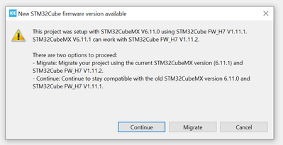

 Although, when I bring it over to the STM32IDE to do scripting I get this message.

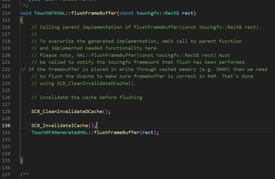

This is the same message I got and asked about in a previous post. Without rehashing that post to much, I am not able to generate GPIO and pinout code correctly if I hit continue. If I hit migrate I am able to script fine but if I need to change the gui on TouchGFX and generate code on that software it now slowly degrades my display until there is nothing left but a white screen. I wanted to see if there if a way to make TouchGFX generate code for STM32CubeMX(Which is currently downloaded at 6.11.1) and to generate code compatible with STM32Cube FW_H7 V1.11.1
Thank you for any time you can spare to help.
‎2024-07-01 03:10 AM
You should migrate indeed.

I realized it needed to be disconnected and connected again. The issue I was having with that same board is when I invalidate one of those widgets. Every time it is invalidated it flashed across the screen and creates the fading/tearing look I was trying to describe. If it is set by a timer or an input it happens less but you can imagine how chaotic it looks running at the speed of the clock.

4) I also tried to edit my code in this file according to a different post I made about the same issue.

I have tried your project. I also get a weird behavior.
I have tried importing q GUI (the pool demo) but I have issues as well.
I have create a new project from Designer and imported the pool demo. This time everything works fine.
It looks like the issue comes from your setup. The quick fix is to create a new project from Designer like I did.
