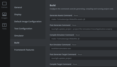

Try in step 3 dont import . When you first time once open part template file only generate empty screen .
Too IDE have long time bug for generate code for dual core TFX. Try install full MX generator and use it for create project for IDE.
‎2023-11-11 11:46 PM - edited ‎2023-11-11 11:47 PM
The issue is till there even if I don't try to import the Touch gfx project and try to generate code for an empty screen, it still gives an error such as it is unable to locate the .cproject file. However the .cporject file is present in the workspace, its unable to locate the .cproject file.
I even upgraded the touch gfx version but i still got same errors.
‎2023-11-12 2:01 AM - edited ‎2023-11-12 2:15 AM
As i write problem is IDE not TFX. And rel source is in call post generate target line in TFX generator. Try correct this line in designer config ...
as you can see 2 years and developers not solve this Why the CubeIDE can't generate an STM32H747 based ... - STMicroelectronics Community
