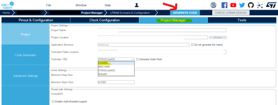

I used TOUCHGFX 4.22.1 to generate code and used IAR 9.40.1 to open the project. When build the project, it shows missing the the file 'Middlewares/Third_Party/FreeRTOS/Source/portable/IAR/ARM_CM4F/port.c' ,
Could you provide a patch to fix it ? Thanks for your help.

You're missing 2 steps.
By default, our TBS already provide generated code for STM32CubeIDE toolchain.
What you need to do is after step 4 :
4.1) Open the ioc file with STM32CubeMX - go to "project manager" menu and select EWARM toolchain - and press generate code
4.2) go to your project under TouchGFX Designer and press generate code
Then you can go to your step 5 :
5- Open your project under IAR
Let me know if that helps.

Hello @Kenwang ,
I've tried it on my side and I can't reproduce this issue. I'm using the same IAR 9.40.1 as you.
Could you provide me more details concerning your project? Like which board are you using? Which STM32CubeMX version?
Also, does your error happens because the file is not there at all, or is it because it isn't included in the IAR project ?

My steps are as follows
1. Launch TouchGFX software
2. Choice STM32H747I DISCO
3. add a box object in project
4. generate code
5. using IAR 9.40.1 to open the project
6. choice convert project formate to fit IAR version
7. build CM4 image, it will success.
8 build CM7 image, iAR will show it miss port.c file
details are in this video 4.22.1 bug in IAR

Thank you so much for your helpful response on the ST forum! Your solution worked perfectly, and I really appreciate you taking the time to assist me. Thanks again!
