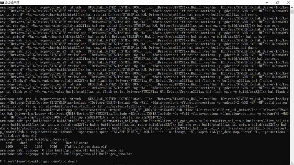

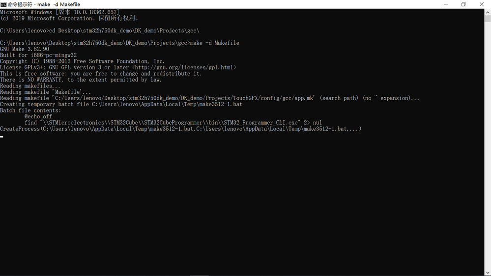

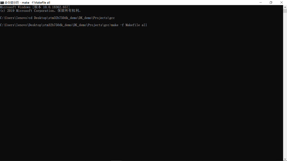

When i use gcc to compile the source code, it shows me nothing.
1/ make -f Makefile all
​2/make -d Makefile
I generate the source code for stm32f103 via stm32cubemx, it compiles well.

‎2020-03-31 8:09 AM
Try making using the TouchGFX Environment. It's set up with everything required.
/Martin
‎2020-03-31 8:09 AM
/Martin
‎2020-04-01 3:00 AM
Hi,Martin KJELDSEN.
Your suggestion is right, and thanks for your attention.
‎2020-04-01 3:33 AM
Nice! You're welcome :)
