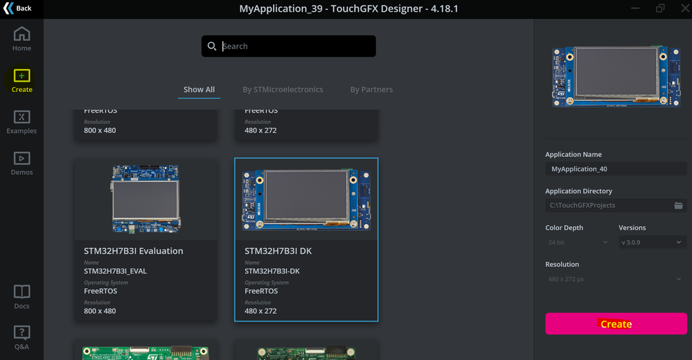

From what I've understood, you created a project without selecting a board on TouchGFX Designer right ? If yes, you can easily run your project with one of our board :)
1) Click on "Create" on the left panel, and select the board you want. Then click on Create.

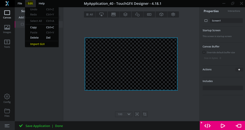

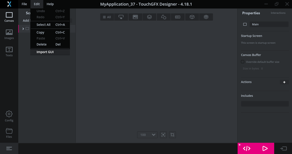

2) Click on "Edit" at the top and "Import GUI"

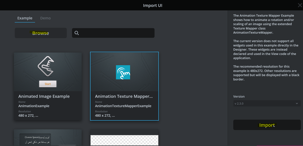

3) Select one of our UIs or you can choose one of yours by clicking on "Browse" (you have to choose the .touchgfx file of your UI) and click on "Import".

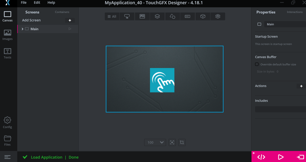

4) Enjoy :)
