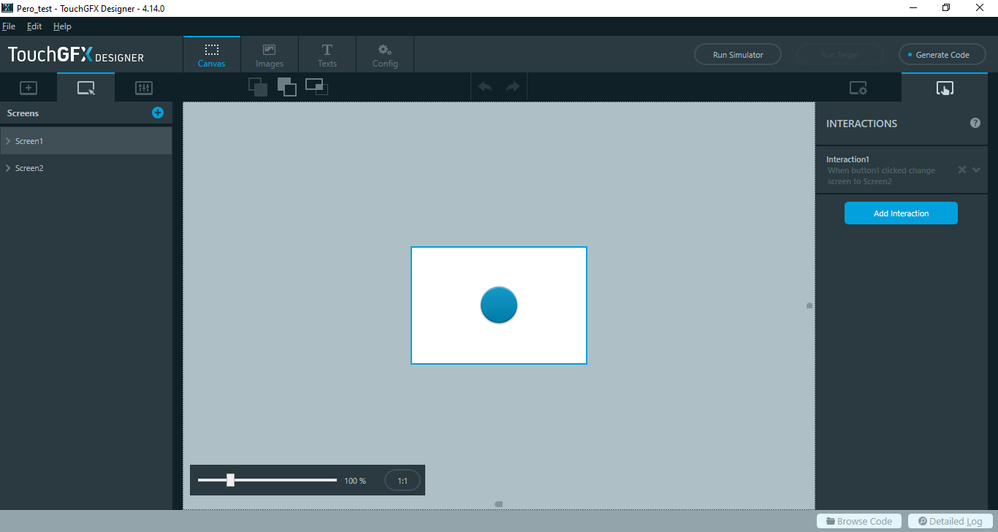

  • Upon code generation, I opened Aplication Template.touchgfx.part in TouchGFX Designer, and made a very basic screen with a circular shaped button. When the button is pressed, the background color is changed, that's it. Very simple.
  • Tested it out in simulator (worked fine), and exported the code into CubeIDE Project.

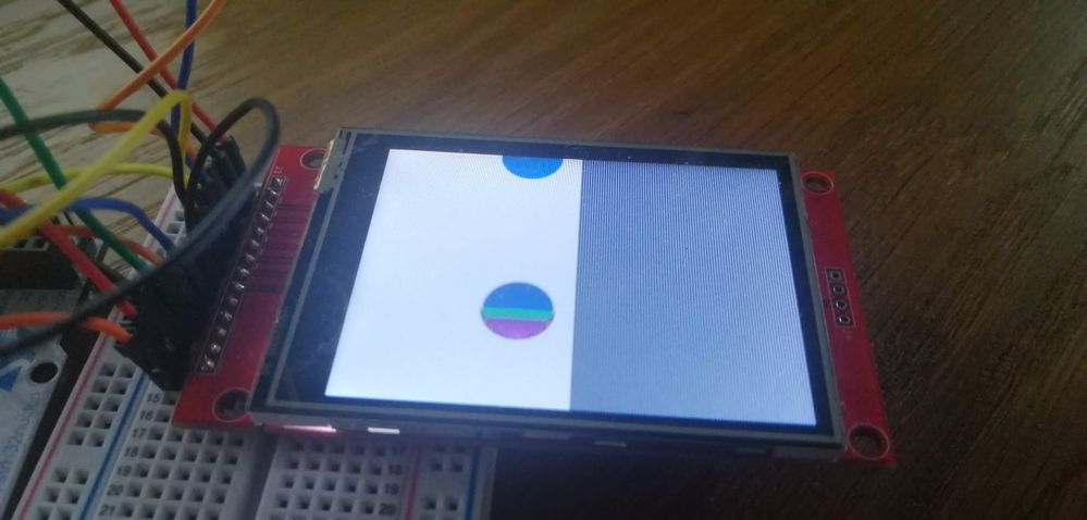

But, the image is a bit weird. First, the button, that is supposed to be centerd is offset, and duplicated. Is there something in TouchGFX that would make such an image detoriation?

Of course, Here is both the screenshot from TGFXDesigner and photo of my actual screen .
Thanks for your interest in helping me, Alexandre!
It seems your UI in Designer is different from what you are trying to display. What I mean by this is that the orientation as well as the size in pixels of your canvas look wrong.
What is the setting in the Designer width x height for your UI ? And then what is the dimension of the the half screen ?
The orientation of your "half screen" needs to match the one on your display as well.
Anyway, I will repeat myself but you need to implement partial framebuffer. Doing this won't lead you anywhere (from my point of view).

I think it might have been it. I modified orientation in the TGX designer from "landscape" to "portrait" and it did the job properly. However, I also needed to mofify @Martin KJELDSEN​'s original copyFrameBufferBlockToLCD function from the Documentation to this:
void TouchGFXHAL::copyFrameBufferBlockToLCD(const touchgfx::Rect rect)
    __IO uint16_t* ptr;
    int16_t height;
    // Use default implementation (CPU copy!).
    // This can be accelerated using regular DMA hardware
    for (height = 0; height < rect.height ; height++)
        //ptr = getClientFrameBuffer() + rect.x + (height + rect.y)  * BSP_LCD_GetXSize();
    	ptr = getClientFrameBuffer() + rect.x + (height + rect.y)*(rect.width);
        LCD_IO_WriteMultipleData((uint8_t*)ptr, rect.width+1);
I think the reason for bad rendering was the wrong size of the framebuffer part I was feeding into the SPI DMA. Since the SPI only works with data lengths of 8 bits, while the framebuffer has 16-bit data points, I need to send twice the amount of pixels needed for single line. This "+1" at line 12 makes sure all of it sent, so that skew is avoided. Sweet.
