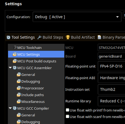

AScha.3
and you have enabled print-float ?
-> use float with printf...
Thanks for the response,
I tried it but its throwing error as ''no matching function for call to snprintfFloat" (argument types are: (uint16_t [11], uint16_t const, char const [8], float, char const *))
FYI, I'm using TouchGfx 4.21.3 for designing LCD screens for my project with ST Microcontroller and updating part of code in Container with two textAreas.
My code:
float tempValue = 32.45f;
tempUnitsTitleType tempUnitsDescTable[] = {
{1, "degC"},
{2, "degF"},
const char* GetTempUnitsString(int8_t enumValue)
{ // Iterate through the table to find the matching enum value
     for (size_t i = 0; i < sizeof(tempUnitsDescTable) / sizeof(tempUnitsDescTable[0]); i++)
           if (tempUnitsDescTable[i].enumValue == enumValue)
              return tempUnitsDescTable[i].unitString;
   } // Return NULL if no matching enum value is found return NULL;
Unicode::snprintfFloat(textArea2Buffer, TEXTAREA2_SIZE, "%.2f %s", tempValue, GetTempUnitsString(1);
Thanks for the response.
I'm not sure where to set this option? can you please provide more details.
As all other settings...
in IDE, select your project as "active now" , by having the main.c open or click in left window on the project name;
then menu->project->properties
select ... (as in pic) C/C++ build -> settings -> MCUsettings -> X use float with printf
(then float lib is included in build for this project )

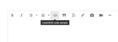

Please insert code samples with the "insert/Edit Code sample" button:
