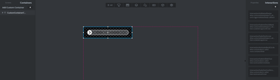

‎2025-05-05 2:58 AM
Hello @blueriver ,
Perhaps the easiest way would be to create a custom container.
Luckily for you, I already made a custom slider that you can take great inspiration from as it can only be moved if we press on the moving part of the slider, you can find it attached.

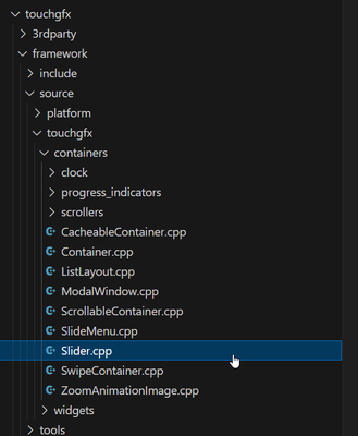

1)
It is probably possible but I think it will be harder.
If you want to go this way, since there is no function to manage the moving element separately, you should copy the class and modify it to your needs.
You can find the base class under touchgfx => framework => source/include => touchgfx => containers => slider.cpp/hpp:

4)
The actionValidatedSwipe() does not validate the swipe nor does it leaves the draggable object at its position.
The draggeable object will stay at its position by itself if we don't do anything (here it moves back because actionFailed would be called c.f. point 5).
Instead, the only thing it does is to act as the trigger for an interaction on TouchGFX Designer :
These actions will fade the different elements so we get the green arrow, it is simply easier to do fades in Designer than in code.

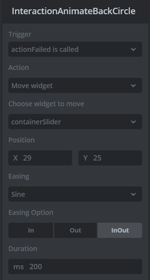

5)
Indeed, it is actionFailed() that makes the moving part snap back to it's start position if the user failed to go all the way to the end.
Or rather, it is actionFailed() that triggers the interaction that makes it happen, because just like for fading, smooth movements are also easier done as an interaction in Designer.
It is that interaction that makes the movement smooth, you can change the values in Designer directly :
