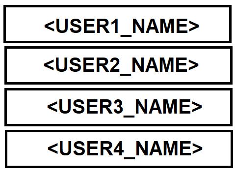

I'm trying to load some text data into a scroll list. Those texts are generated at runtime. I want to show them as list items. Also, the number of elements is not fixed. No sharply defined upper limit and lower limit for the number of elements.
