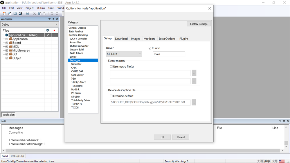

Hi,I am a new developer of stm32h750dk and not familiar with IAR.
OS:Windows 10
IDE:IAR 8.42.2
Tools:ST-link V3 on stm32h750dk board.

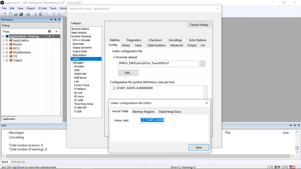

I generate stm32h750dk online application on touchGFX designer 4.12.3.
​I know the flash on chip is designed for bootloader, and the code stored in QSPI Flash.
I know how to download the online application hex file to stm32h750dk on stm32Cube Programmer.
I do not know how to download and debug the source code to the QSPI Flash via IAR.
I want to know if any instructions for download and debug the source code in QSPI Flash via IAR.
The settings of the IAR below.

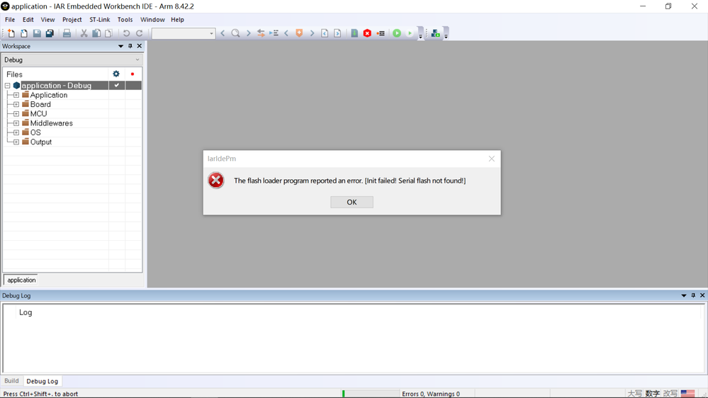

It compiles ok, but download failed, it show me that.
Thanks for your attention.

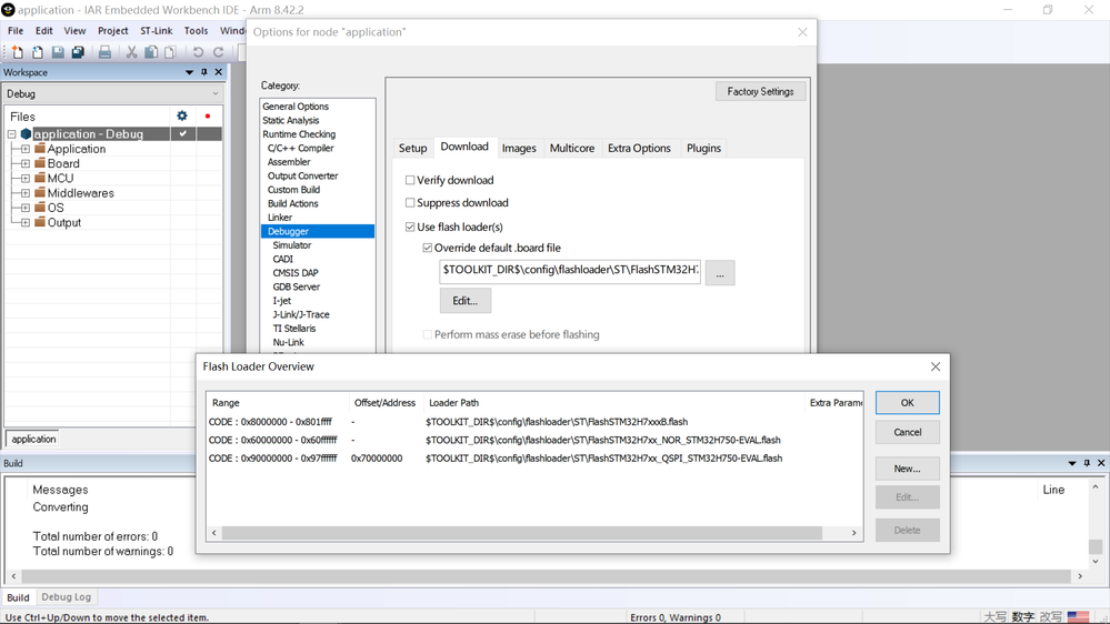

Not an IAR user, but check if there is a DISCO rather than EVAL external flash loader algorithm. The boards are usually wired differently.​
N. SANTINI
Please be aware that some patches (board scripts) are needed to use properly IAR with the H7 family, could you please confirm that you installed the following :
STM32Cube\Repository\STM32Cube_FW_H7_V1.6.0\Utilities\PC_Software\IDEs_Patches\EWARM\EWARMv8_STM32H7xx_Support_V1.1.zip
Best regards,

There is no DISCO in flashloader folder,thanks for your attention.
Hi,Nicolas SANTINI
I installed the support package,but still can not download the source code to QSPI Flash.

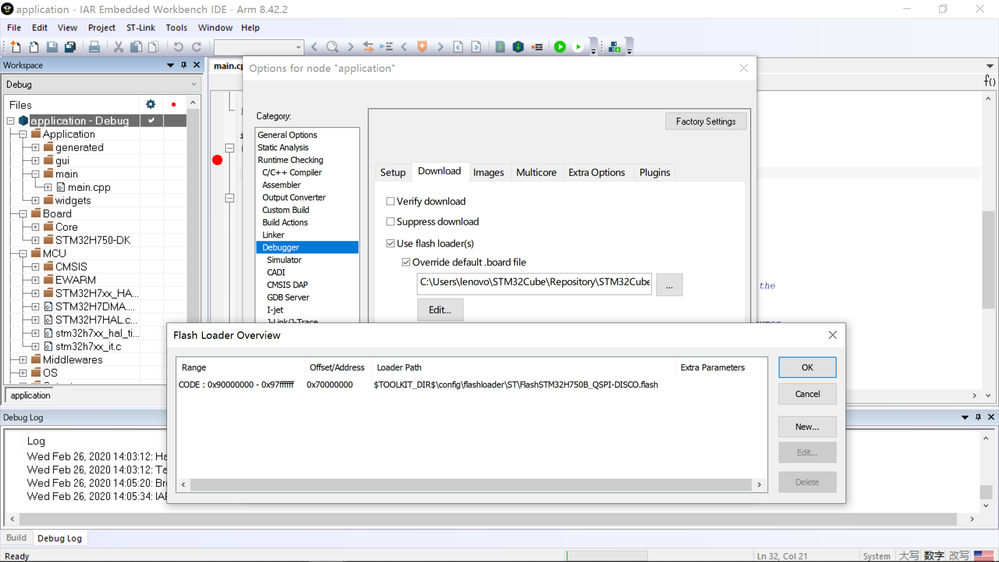

I unpack the patches and copy ​FlashSTM32H750B_QSPI-DISCO.flash and FlashSTM32H750B_QSPI-DISCO.out file to C:\ProgramFile(x86)\IAR Systems\Embedded Workbench8.4\arm\config\flashloader\ST.
Also I choose the FlashSTM32H750B-DISCO.Board (path:STM32Cube\Repository\STM32Cube_FW_H7_V1.6.0\Utilities\PC_Software\IDEs_Patches\EWARM\EWARMv8_STM32H7xx_Support_V1.1\arm\config\flashloader\ST ) on options->Debugger->Downloader.
The settings is that.
I can download and debug the source code via IAR now.
I want to know if the settings is the same or not for user custom board with the same address for QSPI Flash,but the QSPI Flash is different from the QSPI Flash(Mircon MT25QL512ABB) on stm32h750dk.
In other words,I concern if the settings is useful when i use other QSPI Flash on custom board?
