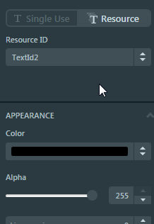

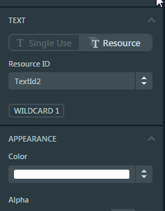

I load example from TOuchGFXDesigner, and look to the textArea's config
But when I try to config my own textArea, I can't see "wildcard" button
what's wrong?
