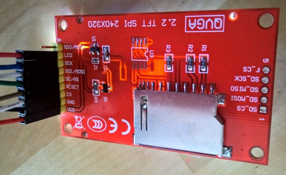

I am searching how to control such displays brightness?
I assume I need to pass less than 3.3V to LED pin? How do I pass less volts?

You could try using a PWM signal

Googled 'qvga 2.2 tft spi "240x320"'. Lots of hits. Very popular. Looks cute.
From its schematic you'd see the controller does the PWM.
Controller is ILI9341 or ILI9340.
From the datasheet's table of contents:
8.2.38. Write Display Brightness (51h).......................................................................................... 141
8.2.39. Read Display Brightness (52h).......................................................................................... 142
8.2.40. Write CTRL Display (53h).................................................................................................. 143
8.2.41. Read CTRL Display (54h) ................................................................................................. 145
8.2.42. Write Content Adaptive Brightness Control (55h).............................................................. 147
8.2.43. Read Content Adaptive Brightness Control (56h) ............................................................. 148
8.2.44. Write CABC Minimum Brightness (5Eh)............................................................................ 149
8.2.45. Read CABC Minimum Brightness (5Fh)............................................................................ 150
You'd send the commands via the SPI.
Comprehensive post about it at https://www.instructables.com/id/Cheap-TFT-22-inch-Display-on-Arduino-ILI9340C-or-I/.
