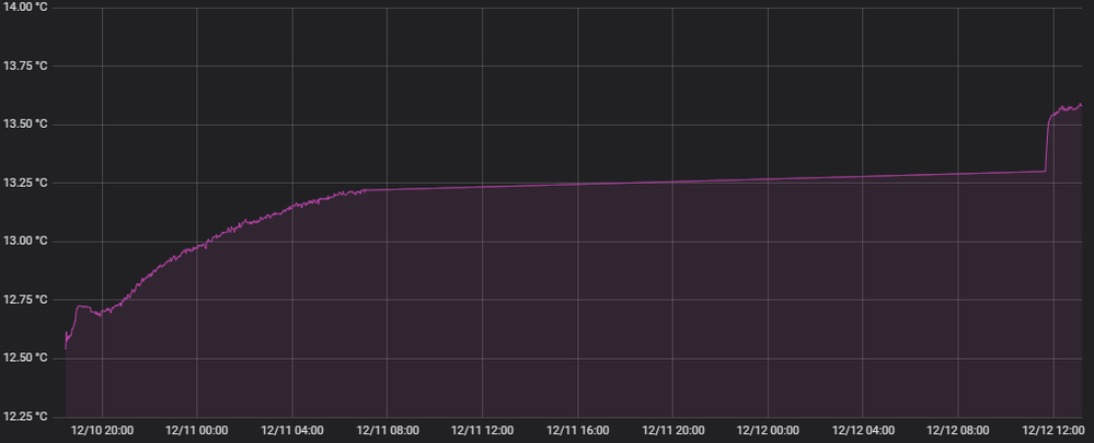

I apologize for the unclear question.  I want to know how to add label like you said : 1970-01-01 00:00:01. For example: we measure temperature every  15 seconds so when temperature is measured i want to add point in graph with corresponding timestamp which is shown on x axis. Is there any example on how to do that ?
Here is a example of what I want:

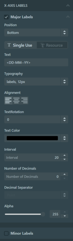

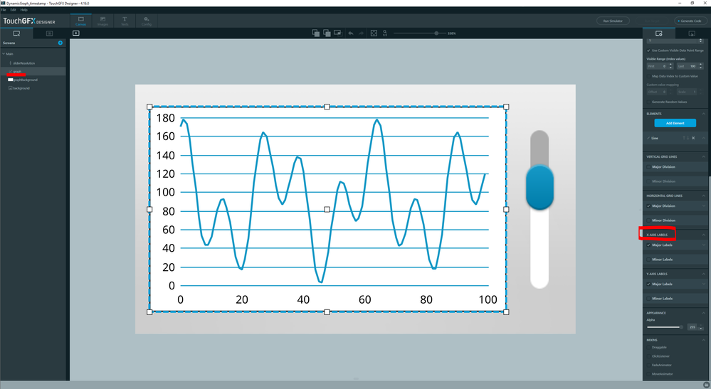

Have a look at the UI template "Dynamic Graph example" available from TouchGFX Designer when you create a project (link to the online documentation). In the "Settings" tab on the right, scroll down to the "X-AXIS LABELS" section.
0693W000007ArqDQAS.pngYou will see how to set how the text of the values on the abscissa are displayed. It corresponds to the way texts are handled in TextArea widgets,
0693W000007ArqSQAS.pngHave a look at the textArea widget article and the UI template "Text Example" to understand how to work with text within TouchGFX Designer.
