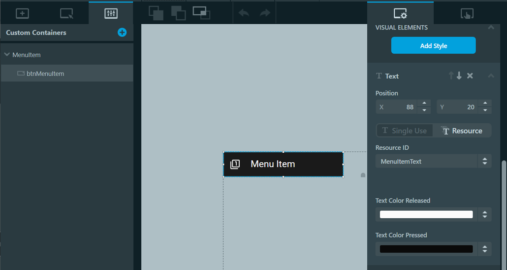

‎2020-08-12 2:56 PM
How does one create a Flex Button w/ wildcard in the designer then? I don't see that option. I have a container called MenuItem with a single component - a flex button. I need to be able to change this text on the fly using Unicode string commands.
‎2020-08-13 1:59 AM
You don't have the wildcard possibility because your resource MenuItemText has no wildcard.
You have to add a <> in the text field of your resource to indicate there is a wildcard.
/Alexandre
