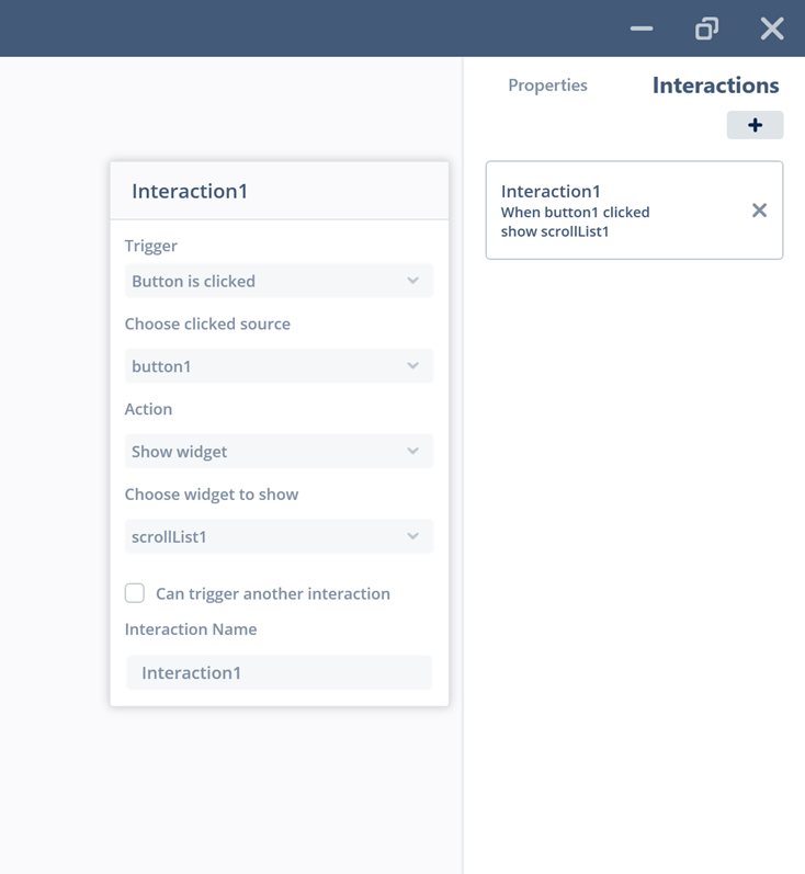

Hello @MA.2​ ,
There is a very easy way to do what you want using TouchGFXDesigner widgets interactions :
  • Click on "Add Interaction"
  • Create an interaction for your button, with trigger "Button is clicked", action "Show widget" and widget to show "ScrollList1".
Don't forget to uncheck the "Visible" checkbox inside the properties of your ScrollList, so it can appear only when the button is pressed, and not before.
Hope that this helped you,
/Yoann

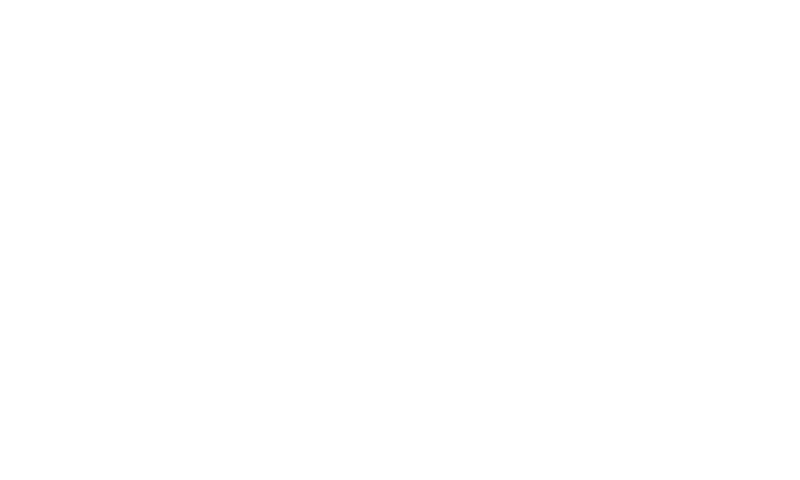

0693W00000KbNiAQAV.bmp can i do the same thing for custom container (radio button inside) if it is yes,
how i hide the container when a radiobutton inside the container is clicked,can you suggest some way to this.
also how to make a selection table for selecting positions like above figure
