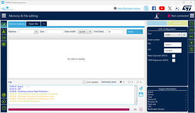

I tried to use USBX DFU to update the firmware on the STM32U575ZI. The DFU mode was detected by STM32CubeProgrammer. However, when I clicked the connection button and disabled Read Out Protection, STM32CubeProgrammer was frozen as shown in the following picture

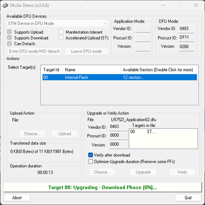

Moreover, I tried to use DfuSe Demo to update the firmware. It erased the flash (I double‑checked this with STM32CubeProgrammer), but it could not write data to the MCU, as shown in the following picture.
Could anyone provide us with some suggestions?

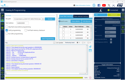

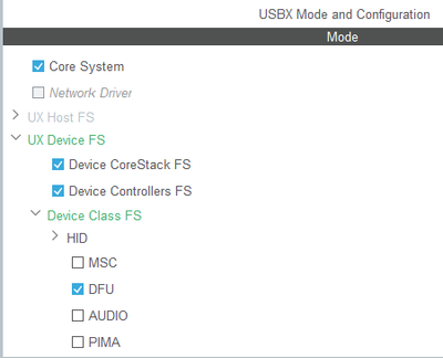

1. I entered DFU mode by connecting PH3_BOOT0 to VDD, and then used STM32CubeProgrammer to update the firmware U575ZI_Application02. The update works well, as shown in the following picture.

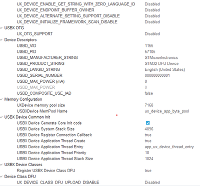

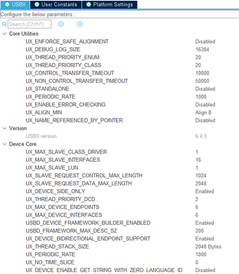

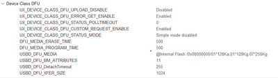

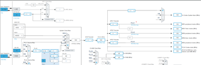

2. The Nucleo-U575ZIQ does not set up the HSE crystal, so I chose the LSE crystal as shown in following picture.
My USB configurations are shown as follows
USBX
(1) Mode
(2) Configuration
