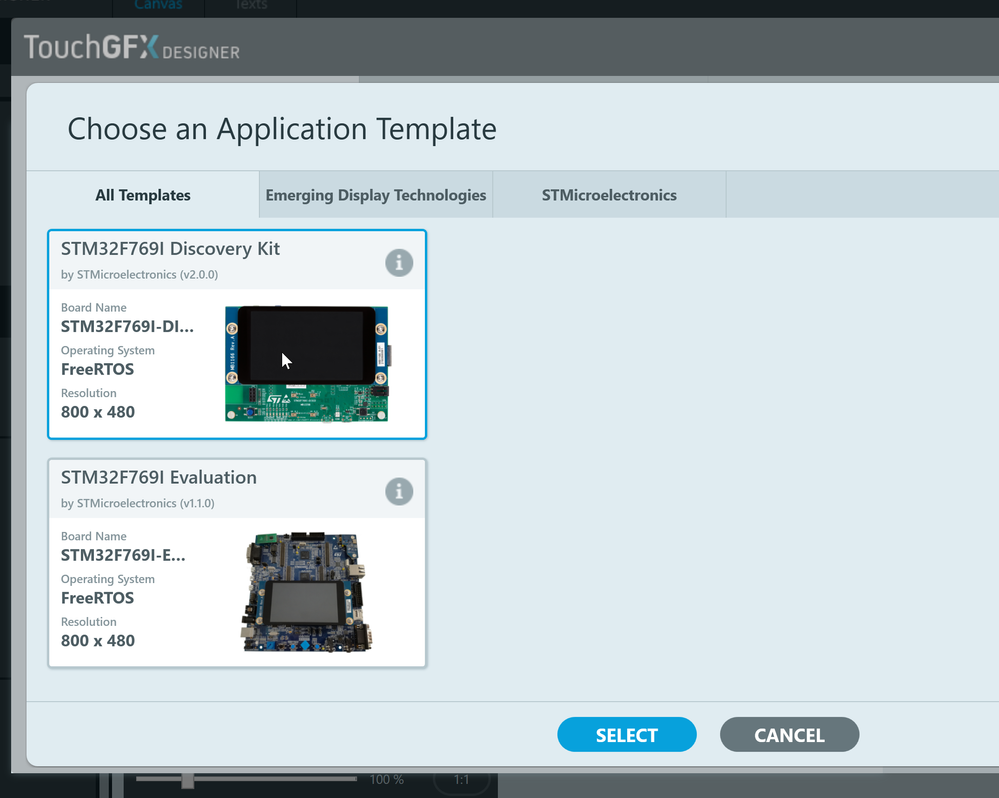

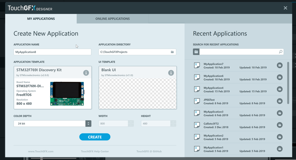

- Download TouchGFX 4.10.0
- Install ST-Link.
- Hook up your STM32F769I-DISCO board through the ST-Link micro-USB port
- Create an application in TouchGFX 4.10.0 based on v2.0.0 of the STM32F769I-DISCO Application Template
- Create your Screen definitions in the designer
- Press "Run target"
It'll work =) And you don't need to be a scientist; Our marketing people do this all the time to create demos without even knowing how to code. Try it out and let me know.
This application will also give you an .ioc file (CubeMX) that you can use to make hardware configuration modifications specific to the STM32F769I-DISCO.

‎2019-02-18 1:50 PM
‎2019-02-20 7:39 AM
I will order the board to play, I hope to get it working. I would like to get for example the .ioc file becasue I want to add like ADC, I2C, DMA.
If I can send it to cube mx from touch GFX. Then I can finish in Keil.
