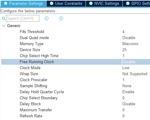

I am using below development tools
MCU: STM32H7B3IIT6
IDE: STM32CubeIDE Version: 1.8.0
GUI: TouchGFX Version: 4.18.1
SDRAM: IS45S16800F-7CTLA1-TR
FLASH: MX25LM51245GMI00
Schematic
static void MX_OCTOSPI1_Init(void)
  /* USER CODE BEGIN OCTOSPI1_Init 0 */
  /* USER CODE END OCTOSPI1_Init 0 */
  OSPIM_CfgTypeDef sOspiManagerCfg = {0};
  /* USER CODE BEGIN OCTOSPI1_Init 1 */
  /* USER CODE END OCTOSPI1_Init 1 */
  /* OCTOSPI1 parameter configuration*/
  hospi1.Instance = OCTOSPI1;
  hospi1.Init.FifoThreshold = 1;
  hospi1.Init.DualQuad = HAL_OSPI_DUALQUAD_DISABLE;
  hospi1.Init.MemoryType = HAL_OSPI_MEMTYPE_MICRON;
  hospi1.Init.DeviceSize = 26;
  hospi1.Init.ChipSelectHighTime = 2;
  hospi1.Init.FreeRunningClock = HAL_OSPI_FREERUNCLK_DISABLE;
  hospi1.Init.ClockMode = HAL_OSPI_CLOCK_MODE_0;
  hospi1.Init.WrapSize = HAL_OSPI_WRAP_NOT_SUPPORTED;
  hospi1.Init.ClockPrescaler = 3;
  hospi1.Init.SampleShifting = HAL_OSPI_SAMPLE_SHIFTING_NONE;
  hospi1.Init.DelayHoldQuarterCycle = HAL_OSPI_DHQC_DISABLE;
  hospi1.Init.ChipSelectBoundary = 0;
  hospi1.Init.ClkChipSelectHighTime = 0;
  hospi1.Init.DelayBlockBypass = HAL_OSPI_DELAY_BLOCK_BYPASSED;
  hospi1.Init.MaxTran = 0;
  hospi1.Init.Refresh = 0;
  if (HAL_OSPI_Init(&hospi1) != HAL_OK)
    Error_Handler();
  sOspiManagerCfg.ClkPort = 1;
  sOspiManagerCfg.DQSPort = 1;
  sOspiManagerCfg.NCSPort = 1;
  sOspiManagerCfg.IOLowPort = HAL_OSPIM_IOPORT_1_LOW;
  sOspiManagerCfg.IOHighPort = HAL_OSPIM_IOPORT_1_HIGH;
  if (HAL_OSPIM_Config(&hospi1, &sOspiManagerCfg, HAL_OSPI_TIMEOUT_DEFAULT_VALUE) != HAL_OK)
    Error_Handler();
  /* USER CODE BEGIN OCTOSPI1_Init 2 */
  BSP_OSPI_NOR_Init_t Flash;
  Flash.InterfaceMode = BSP_OSPI_NOR_OPI_MODE;
  Flash.TransferRate  = BSP_OSPI_NOR_DTR_TRANSFER;
  BSP_OSPI_NOR_DeInit(0);
  int32_t RetVal = BSP_OSPI_NOR_Init(0, &Flash);
  if(RetVal != BSP_ERROR_NONE)
    Error_Handler();
  RetVal = BSP_OSPI_NOR_EnableMemoryMappedMode(0);
    Error_Handler();
  /* USER CODE END OCTOSPI1_Init 2 */
I am trying to activate octospi as custom board design, but the program gives an error. The program gets an error at the following place? What do you think could be the reason?

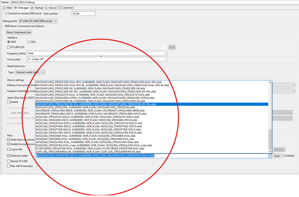

Hi @Patrickhiapello​  I created external loader. But external loader file dont seem debug window. Do you have advice?
Great!
Good job!
ahahah yes i know :)

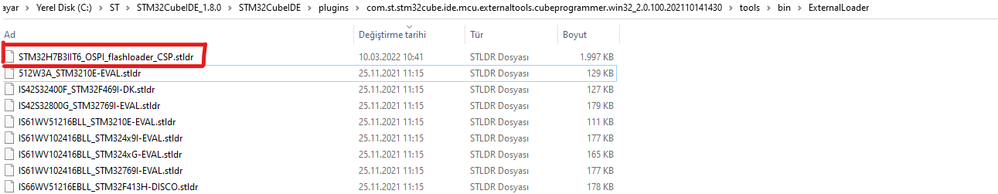

If you put this file for STM32CubeProgrammer you can "see" the file.
But if you put the same file for STM32CubeIDE you can not "see" the file.
Correct?

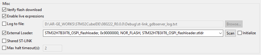

The problem is the name inside Dev_Inf.c
"QSPI_flashloader_CSP",      // Device Name + version number
Has to be egual to generate file stldr so ->QSPI_flashloader_CSP.stldr
Put name you want egual inside and outside the file in Dev_Inf.c
"franco",      // Device Name + version number
and generate file franco.stldr
Then you finally have your extenal loader work in STM32CubeIDE!

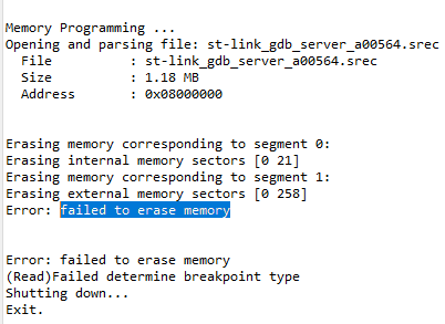

Hi @Patrickhiapello​ Thank you for support. I did your advice and I could see .*stldr file. But I see failed to erase memory. I wil create new post with "External OctoSPI loader how to".
Topics can be mixed. I will create a new topic.
