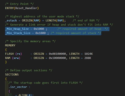

Another solution would be to increase the TouchGFX heap in the linker script (in the "gcc" folder, the file with the LD extension):
You can increase the minimum heap and stack from there.

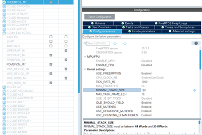

A final solution is to increase the FreeRTOS stack size (if you use FreeRTOS) in the .ioc file :
