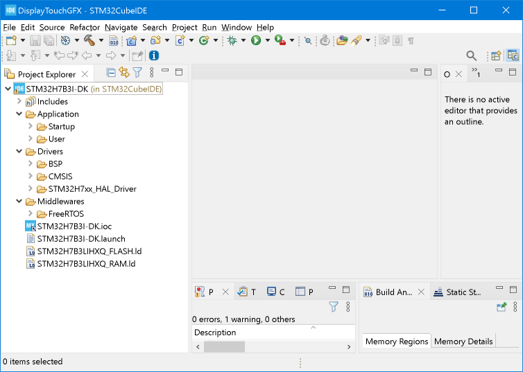

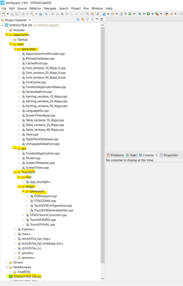

‎2022-10-03 4:24 AM

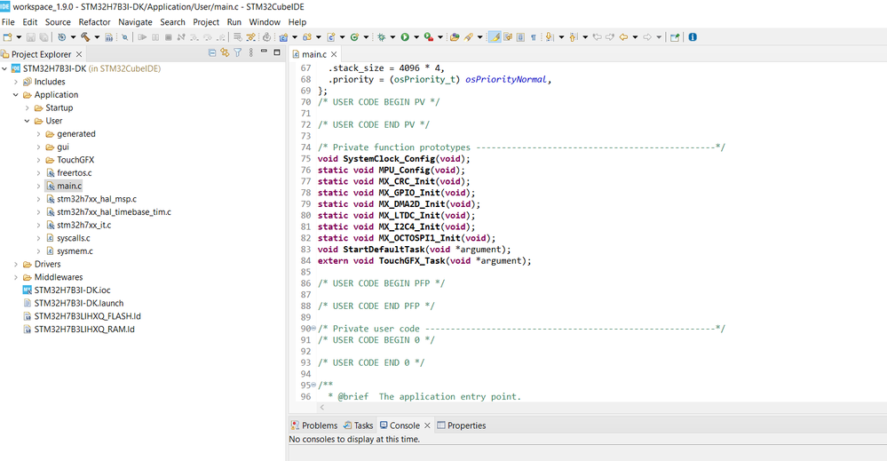

Hello again MMüll.6,
I do the 2nd way always, but I think you're missing one step;
- Start with TouchGFX:
- Simulator works directly
- Download with TouchGFX works
- GENERATE CODE WITH TOUCHGFX DESIGNER (press F4)
- Open CubeIDE : it should work.
- All the TouchGFX generated files & user code are visible
Can you try that ?
/Osman

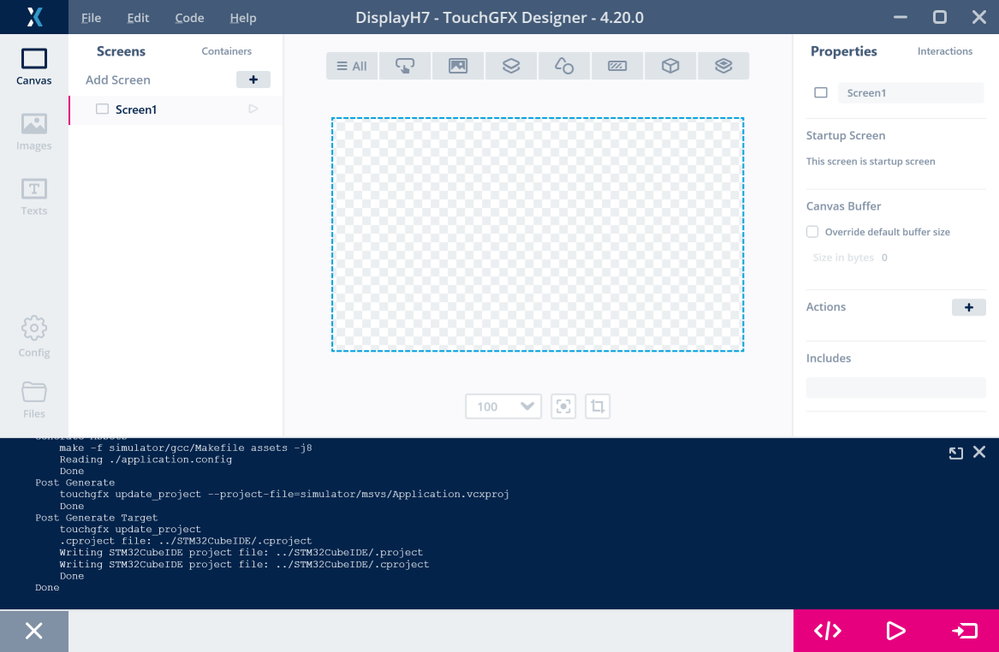

‎2022-10-03 4:37 AM

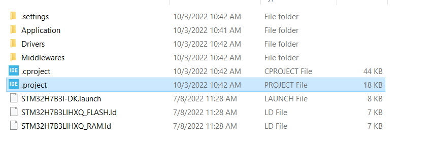

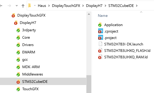

I have generate the code with TouchGFX designer:
‎2022-10-03 4:44 AM
‎2022-10-03 5:38 AM
Please, can you generate a new project with the demo board "STM32H7B3I-DK" for TouchGFX and CubeIDE with the name "DisplayH7".
Then I can download this, it will be very nice.
Thank you very much.
/Markus

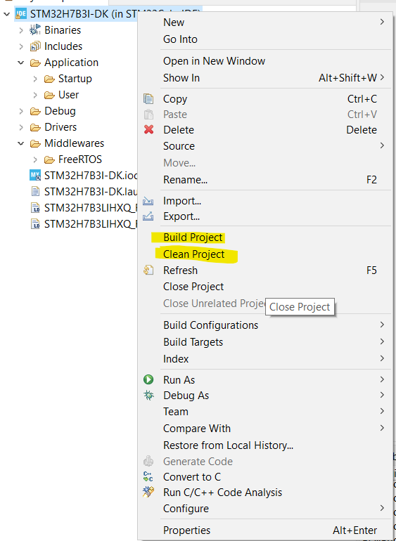

‎2022-10-03 7:22 AM

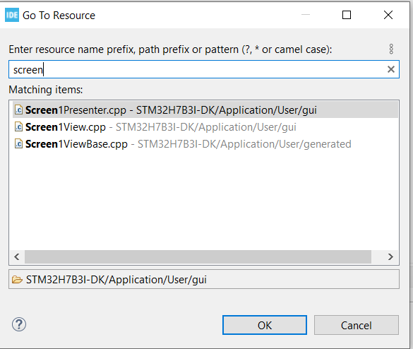

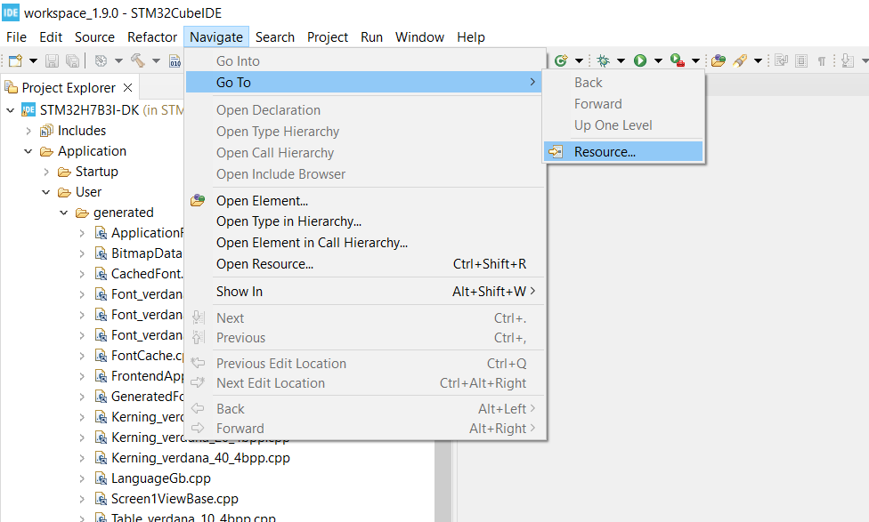

Nothing is missing :grinning_face_with_sweat:
I opened your project you shared, and I find all the files.
I opened TouchGFX Designer, I regenerate code from there. Then in STM32CubeIDE, I cleaned the project (right click, "Clean Project"), then I built it (right click, Build Project"). No errors, no warning during compilation. So the project is working.
If you can't find a specific resource file in the tree, try to do a global search by its name like this :
/Osman
