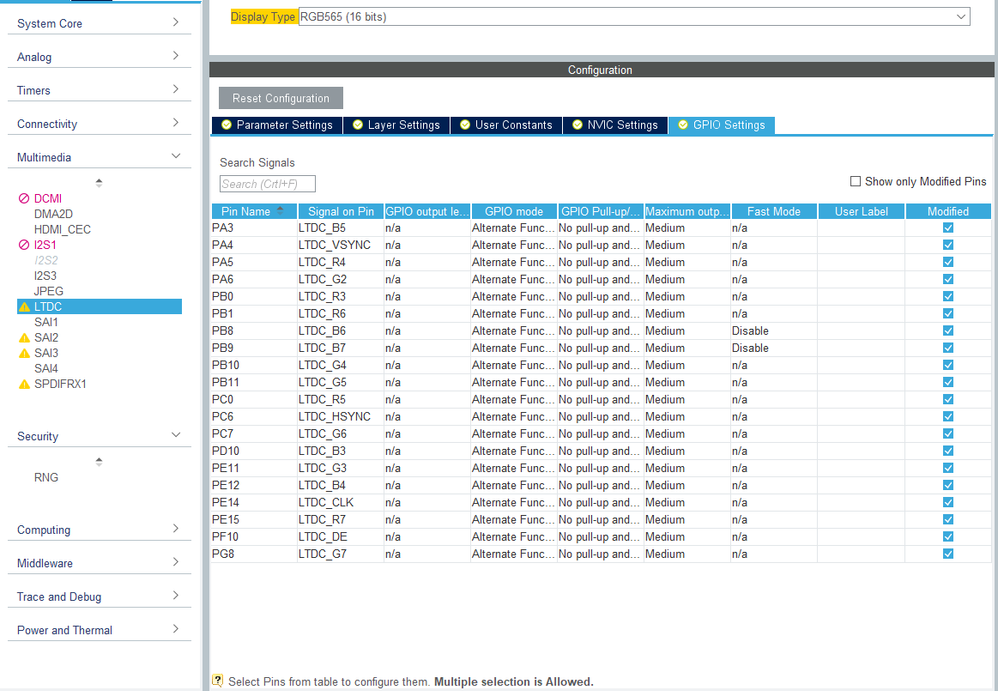

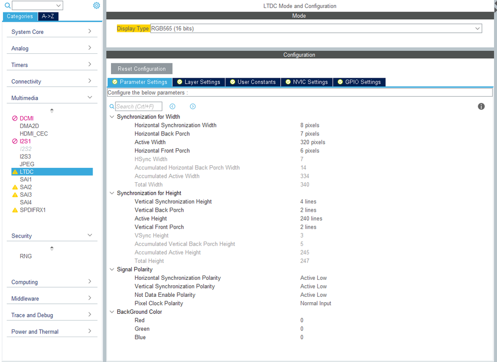

Hi I'm using STM32H743 nucleo 144 with ltdc configurations and I'm using internal clock. The program stacks in ltdc init() in lines that initialize GCR register. What can be the problem? Below are some configuration of ltdc

The problem, in my case, seems to be caused by a CubeMX bug.
The VCO Range of the PLL3 (the one used to generate the pixel clock of the LTDC module) cannot be selected in MEDIUM mode but only WIDE.
If one of the PLL outputs (P, Q, R) have a frequency higher than 192MHz there are no problems, otherwise the microcontroller will stall during the initialisation phase of the LTDC module because the pixel clock is not active.
It is possible to solve the problem in two ways, the first one is to set one of the three outputs, if not used (P, Q or R) with a clock at 200MHz for example, the other solution is to manually modify the PeriphClkInitStruct.PLL3 parameter. PLL3VCOSEL from RCC_PLL3VCOWIDE to RCC_PLL3VCOMEDIUM.
