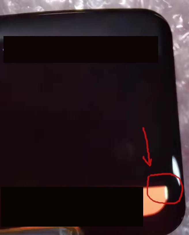

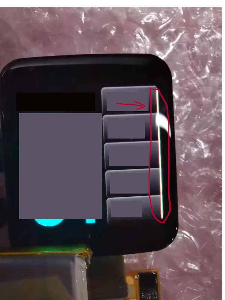

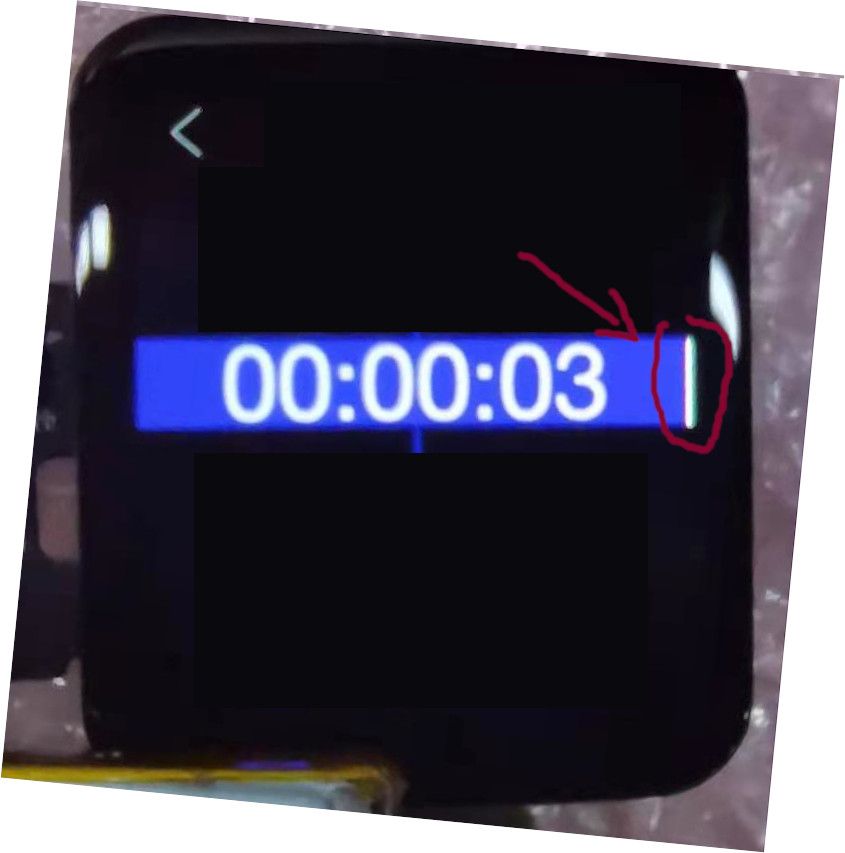

Hello, i hava got a problem with full scrren size controls. Sometimes, there will be a flash line end of the controls. What i suppose to do with this problem?

Thank you for your answer. Sorry, but this really puzzles me. if it is a framebuffer or porch data problem, shouldn't all similar scenarios go wrong? And, I used RGB888 configuration in TouchGFX Designer.

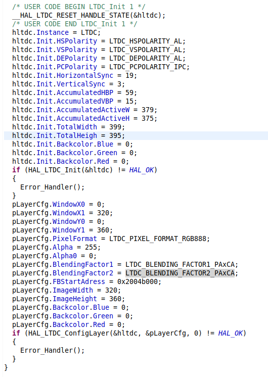

This is my LTDC init code. The problem is not always here. Once this problem occurs next to a control that has had a problem, then all the control that has the problem will have this problem again. Is it possible that something is wrong with the screen itself?

320x360x3=345600 and your FBStartAddr is 300k in SRAM , you dont get info how STM you use, Where is your FB ???
‎2020-12-30 11:18 PM
I used RAM for FB. Start Addr = 0x2004b000, len = 0x200a000 (340k). How STM I used? Sorry, I dont understand.:face_with_tears_of_joy:
When I touch the screen in a certain way, this line will go out, so I think there may be something wrong with the screen.

WTF len = 0x200a000 (340k) ???
STM32XXXX ??? internal ram over 600k ???

OK SRAM3, but len = 0x200a000 is bad
How method you use to reserve framebuffer memory?
Now seems stack or heap data overwrites your end bytes in FB
