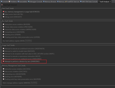

I am working on STM32F426 with TouchGFX. However, after I upgrade STM32CUBEIDE and TouchGFX to latest version, I got a hard fault error. In the stack information, it shows the hard fault happens after touchgfx::muldivu() called.
And in the fault analyzer, the fault is to attempt to perform a division by zero.
May I know if there is any way to solve it? Thanks.
Don't attempt to divide by zero!

Looks more deeply in the library, so probably from a parameter or table passed in. Or corruption to said table or structure.
The call tree might be the most enlightening at this depth. Or some asserts to catch impending failure earlier.
Some thing where you expect a list with 2 elements but pass only one? N-1
