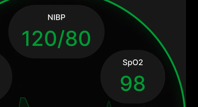

I'm working on a GUI that monitors several values, like in the screenshot.
What is the best way to create those gray blocks. Should I add a background image will all the circle + gray boxes + text, and then render the values. Or should I create circle + gray boxes + text using widgets?
Also, whats the best way to create those gray boxes?

As @Peter BENSCH said, if the boxes won't move, you can simply integrate them directly on the background image (if you use a background image).
Otherwise, there is 2 ways to create these boxes :

Well, if the grey boxes with rounded sides and the green circle are static objects, you should define them together as a background image and place the changing numerical values in front of them. This also has the advantage over permanent generation with a widget of saving valuable computing time and thus improving the response time of your overall system.
The question of how you should create these grey boxes depends on whether you want to create them as a background image or with the STM32. In the latter case, you can render them quite time-consuming or calculate them more easily with an STM32U5 with NeoChrom Vector Graphics GPU.
