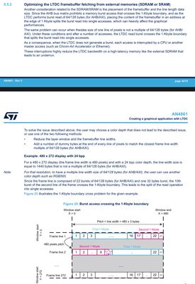

Thanks for the clarification and sorry for the misunderstanding.  It might be a synchronization issue of the framebuffer usage  . Can you have a look to this application note :
https://www.st.com/resource/en/application_note/an4861-introduction-to-lcdtft-display-controller-ltdc-on-stm32-mcus-stmicroelectronics.pdf
Hope it helps ,
STOne-32
AQue
AQueAuthor
July 26, 2024
Thank you for this application note as I have not seen it before.
This specific section on the 1 KiB boundary I don't see as an issue in this case.  My screen size is 1024x600 in RGB888.  Since the width is 1024, it follows that every line is on a 1 KiB boundary (as well as 64 and 128 byte boundaries as well).
I will read the entire application note to see what addition information I can learn.
