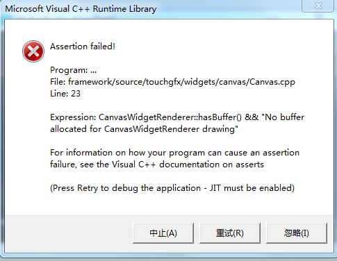

Graph from GitHub/Touchgfx Open Repository: No Buffer Allocated
Zwei.9
0690X00000AAFOjQAP.bmpWhen I run it,i get this dialog.
Martin KJELDSEN
Chief III
Hi @ASar​,
It says so in the popup. "No buffer allocated". Try inserting this into your view:
#define CANVAS_BUFFER_SIZE (3600)
static uint8_t canvasBuffer[CANVAS_BUFFER_SIZE];
CanvasWidgetRenderer::setupBuffer(canvasBuffer, CANVAS_BUFFER_SIZE);
/Martin

Zwei.9
Thank you very much!
