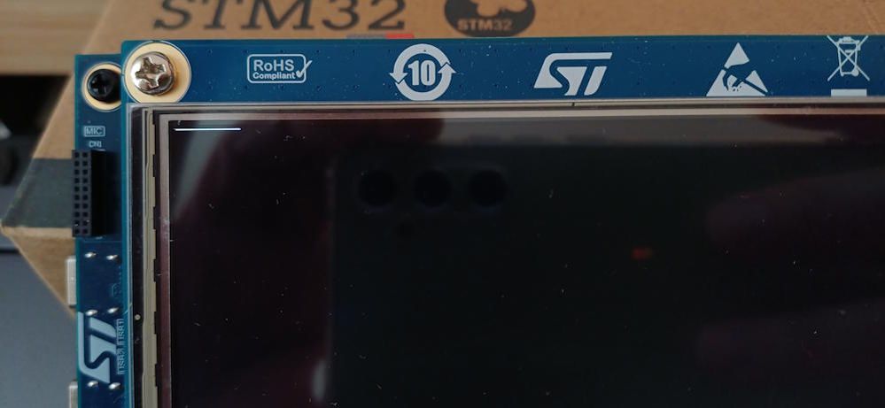

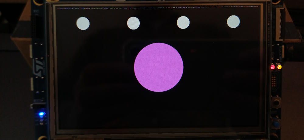

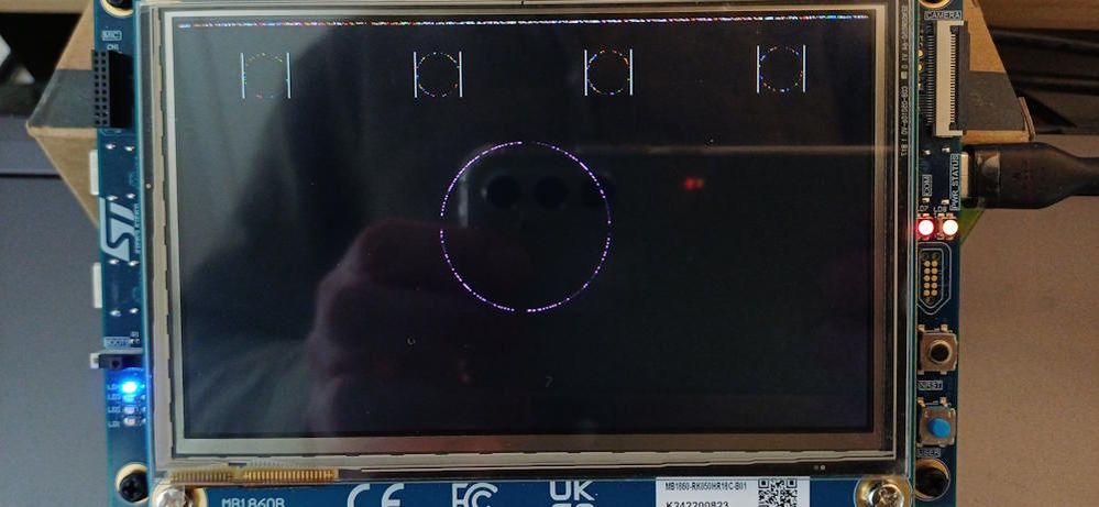

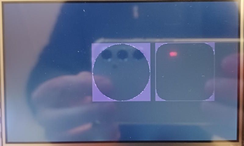

Hi, I have been using NemaGFX on STM32U5G9J-DK2 kit with no problems however my luck with the STM32H7S78-DK kit is different.
1. The NemaGFX for this platform only seems to work with 32-bit framebuffers, not 24-bit ones. Or am I doing something wrong?
2. The NemaGFX for this platform uses the beginning of the framebuffer as a sort of workspace. We see random dots at the beginning. I think I'm having trouble allocating buffers correctly.
3. I can draw filled rectangles, but filled circles with 'nema_vg_draw_circle()' only show the edge slightly and produce small images in a sort of workspace at the beginning of the frame buffer.
nema_vg_set_fill_rule(NEMA_VG_FILL_NON_ZERO); does not fill the shape, as it should.
Well, 'nema_vg_draw_rect()' works fine with nema_vg_set_fill_rule(NEMA_VG_FILL_NON_ZERO).
4. Many more graphics functions don't work properly on the STM32H7S78, but they all work fine on the STM32U5G9J, which one uses 24-bit framebuffers, while the STM32H7S78 can only work with 32-bit framebuffers, it seems. This could be a reason.
nema_vg_set_fill_rule(NEMA_VG_FILL_EVEN_ODD); It does fill the circle, but there still are the four small images in the frame buffer displayed in white.
What am I doing wrong?

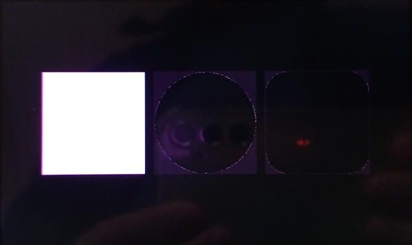

So I use the next framebuffer, and I don't have the random pixels at the top, but it doesn't solve drawing a filled circle, rounded filled rectangle, and a lot of other functions don't work properly.
Note the filled rectangle with no rounded corners works, but a rounded filled rectangle only shows the corners somewhat, it has the same problem as the filled circle:
nema_vg_set_fill_rule(NEMA_VG_FILL_EVEN_ODD); (this is not the solution!)
What did I miss?
I have been careful with caching, I think, the GPU2D works from memory, not cache.
When I run nema_stencil_init(), a row of white dots appears at the beginning of the framebuffer.
This happens if this function calls one of these:
- nema_vg_init()
- nema_vg_init_stencil_pool(DISPLAY_SIZE_W, DISPLAY_SIZE_H, 1);
- nema_vg_init_stencil_prealloc(fbo.w, fbo.h, stencil_bo);
So something is definitely wrong. Even when nema_vg_init() is executed, this seems to happen, regardless of where my framebuffer is located.
What can I to better?
Thanks for any help, it is much appreciated!
BTW, on a STM32U5G9J-DK2 (m33) all works fine

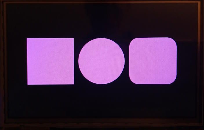

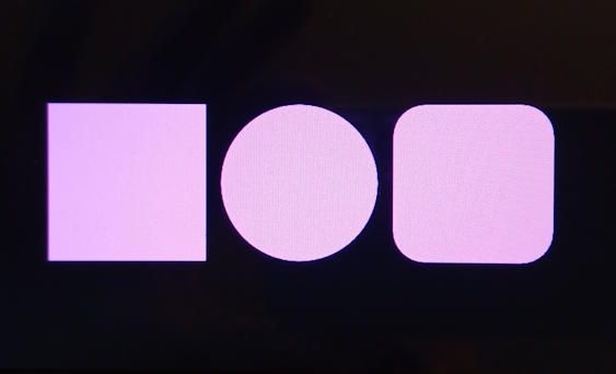

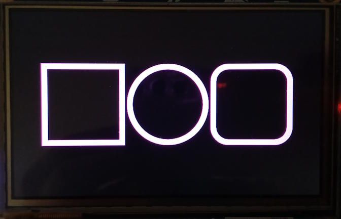

Hi @Jack3
Let's try to take a step back and start from one of the NeoChromSDK examples (I tested with version 1.3.0):
start with this:
\NeoChromSDK\Projects\STM32H7S78-DK\Applications\GPU2D\vector_watchface\
Find the file
\NeoChromSDK\Projects\STM32H7S78-DK\Applications\GPU2D\vector_watchface\Src\svg.c
Replace the app_main() function in that file with this:
void app_main()
 nema_vg_init_stencil_pool(RESX, RESY, STENCIL_MEM_POOL_ID);
 nema_cmdlist_t cl = nema_cl_create_sized(8 * 1024);
 nema_cl_bind_sectored_circular(&cl,8);
 unsigned char green_channel = 0x00;
 while(run)
 img_obj_t *fbo = get_current_framebuffer();
 nema_bind_dst_tex((uintptr_t)fbo->bo.base_phys, fbo->w, fbo->h, fbo->format, fbo->stride);
 nema_set_clip(0, 0, RESX, RESY);
 nema_clear(nema_rgba(0xff, green_channel++, 0, 0xff));
 nema_matrix3x3_t m;
 NEMA_VG_PAINT_HANDLE paint;
 paint = nema_vg_paint_create();
 nema_mat3x3_load_identity(m);
 // nema_mat3x3_translate(m, 0.0, 0.0); // fun to play with
 // nema_mat3x3_rotate(m, 0.0); // fun to play with
 // nema_mat3x3_scale(m, 1.0, 1.0); // fun to play with
 nema_vg_paint_set_type(paint, NEMA_VG_PAINT_COLOR);
 nema_vg_paint_set_opacity(paint, 1.0);
 nema_vg_paint_set_paint_color(paint, nema_rgba(0xFF, green_channel, 0xFF, 0xFF));
 nema_vg_stroke_set_width(15.0);
 // Choose a fill rule
 nema_vg_set_fill_rule(NEMA_VG_STROKE);
// nema_vg_set_fill_rule(NEMA_VG_FILL_EVEN_ODD);
// nema_vg_set_fill_rule(NEMA_VG_FILL_NON_ZERO);
 // Basic blend mode setup for now
 nema_set_blend_fill(NEMA_BL_SRC_OVER);
 nema_vg_set_blend(NEMA_BL_SRC_OVER);
 nema_enable_aa_flags(1);
 nema_vg_set_quality(NEMA_VG_QUALITY_MAXIMUM);
 nema_vg_draw_rect(80, 140, 200, 200, m, paint);
 nema_vg_draw_circle(400, 240, 100, m, paint);
 nema_vg_draw_rounded_rect(520, 140, 200, 200, 40, 40, m, paint);
 nema_cl_submit(&cl);
 nema_cl_wait(&cl);
 swap_buffers(); // wait for sync up with the LTDC controller
 nema_vg_paint_destroy(paint);
 nema_cl_unbind();
 nema_cl_destroy(&cl);
This example draws your three vg shapes. All the exotic blending operations from previous is reduced to simple NEMA_BL_SRC_OVER. The rending is in sync with the LTDC by calling swap_buffers(). In this configuration you can play with nema_vg_set_quality() and nema_vg_set_fill_rule(). This configuration draws every time on my board.
Can you reproduce this setup?
Regards,
Jakob

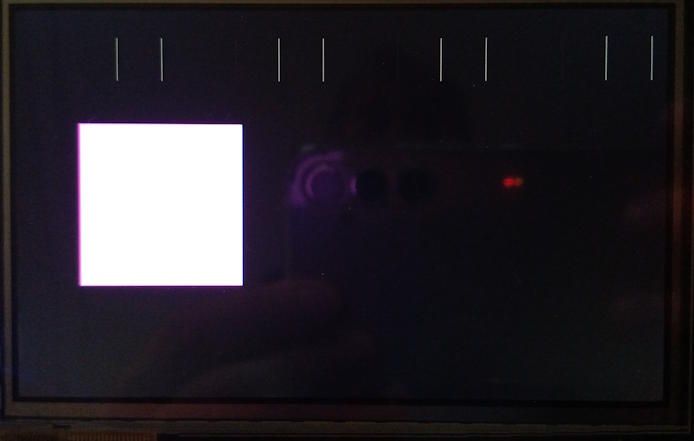

4.   I've also added the GFXMMU functionality in the project to support 24-bit framebuffers, and modfied "MX_LTDC_Init" to use the GFXMMU base address as the LTDC start address.
Despite this, in 24-bit mode, vertical lines were displayed over the full width with no GPU2D output seen.
I would be able to get this working, but only once the GPU is up and running. First things first, I think.

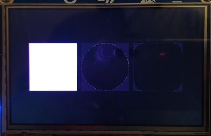

But I think it's a small pool of working space that really needs to be placed outside the framebuffer.
The unwanted ghosting seems to be related to borrowing it from the actual framebuffer for no apparent reason.
It's this part of the initializing that I don't understand. I need to find a way to specify another place for this workspace, not inside the framebuffer. I can't get this done, yet.
So we I can render some things (rectangles with sharp corners, for example), but a lot of things aren't working yet, like filled circles or filled rounded rectangles.
With stroked versions of these, they work surprisingly well, like before. I just wanted to note this again.
Note: Ghost images at the top: NemaGFX uses workspace inside the framebuffer!
The shown ghost images only reflect the rendering of the two right primitives.

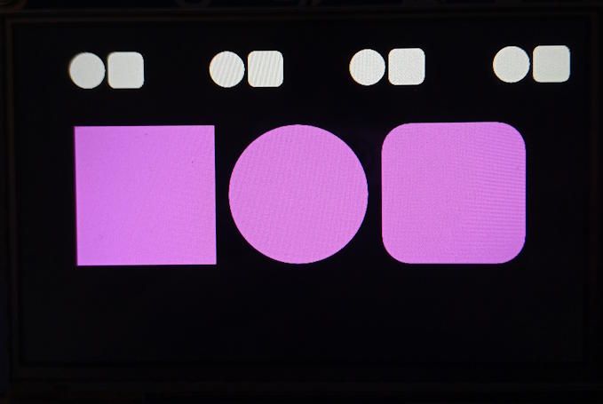

Remember, the in the above picture shown shown ghost images reflected the two right primitive.
They no longer appear in the image below, using NEMA_VG_FILL_NON_ZERO.
After this, I start drawing lots of random colored stroked rectangles at random positions 80x80, stroke 10.
STM32H7S7L8 600MHz 32BPP: 7120 rectangles/sec.
STM32U5G9ZJ 170MHz 24BPP: 11200 rectangles/sec.

In this example, the last two functions are not renedering correctly. However, there are more functions that expose renderings issues.
nema_vg_draw_rect(80, 140, 200, 200, NemaGFX.m, NemaGFX.paint); /* Works */
nema_vg_draw_circle(400, 240, 100, NemaGFX.m, NemaGFX.paint); /* Fails*/
nema_vg_draw_rounded_rect(520, 140, 200, 200, 40, 40, NemaGFX.m, NemaGFX.paint); /* Fails*/
The difference between the STM32H7S7 and the STM32U5G9:
The STM32H7S7 (Cotex-M7) reveals rendering issues in the 2nd and 3rd shape:
The STM32U5G9 (Cotex-M33) works flawless:

I have recreated your described setup, and I now understand broadly what is going on. And I even found a workaround that makes it possible to render the rounded rect with fill rule set to NEMA_VG_FILL_NON_ZERO.
In fact this bug is also showing with nema_vg_draw_ellipse(), but that is also the only draw functions that are affected. One could argue that since this only applies to ellipse and rounded rect, then it should not matter which fill rule are used (Non zero or even odd), the end result is the same.
But should you want to keep the NEMA_VG_FILL_NON_ZERO overall when drawing rounded rectangles you can make this work by setting the VG Quality parameter to max. So you want to do something like this:
 nema_vg_paint_set_paint_color(paint, nema_rgba(0xff,0x68,0xb4,0xff));
 nema_vg_draw_circle(180, 240, 100, m, paint);
 nema_vg_draw_ellipse(400, 240, 100, 50, m, paint);
The reason why this works lies in the way that the library optimizes. Some drawing operations even though they are vector graphics does not need to render using the stencil buffer, this improves performance, but unfortunately in this case there is a bug in this corner with the current library.  When setting NEMA_VG_QUALITY_MAXIMUM all vg drawing operations are forced through the stencil buffer which you will see works as expected.
Most drawing operations are always using the stencil buffer, including vector fonts. And it is also in vector fonts where we typically see an importance for using the right NEMA_VG_FILL_*. But I would say it is generally accepted that if a font renders different with "non zero" and "even odd" then the font is ill designed.
Anyway, the bug has been reported to the backend team and I hope it will be fixed in the next release of the library. Until then I recommend keeping with NEMA_VG_FILL_EVEN_ODD or NEMA_VG_QUALITY_MAXIMUM.

The result is dat no hang occurs (after this test, rectangles with random color and position are printed endlessly).
I noticed that commenting out this line causes the rectangle on the left to no longer display:
// nema_vg_set_blend(NEMA_BL_SRC_OVER| NEMA_BLOP_SRC_PREMULT | NEMA_BLOP_SRC_CKEY); // not needed / does nothing when drawing filled shapes
The other two shapes look the same:
I tried the NemaGFX SDK v1.3.0 and the one provided by TouchGFX studio, and I'm using
libnemagfx-float-abi-hard.a
So, something else must be wrong, I guess.

I played with the clocks as well.
Is it possible to send me a zip file with the working test project so I can try to fix the problem that way?
Best regards, Jack.
JBJOE.1
JBJOE.1Best answer
Oct 30, 2025 11:35 AM UTC
Hi @Jack3
start with this:
Find the file
void app_main()
 while(run)
 nema_matrix3x3_t m;
 nema_cl_wait(&cl);
 nema_cl_unbind();
Regards,
Jakob
