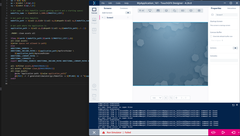

I have investigated some more based on your post. Here are my findings:
If I do what the OP does, it does not work. Note the error message that shows the path with the slashes stripped out:

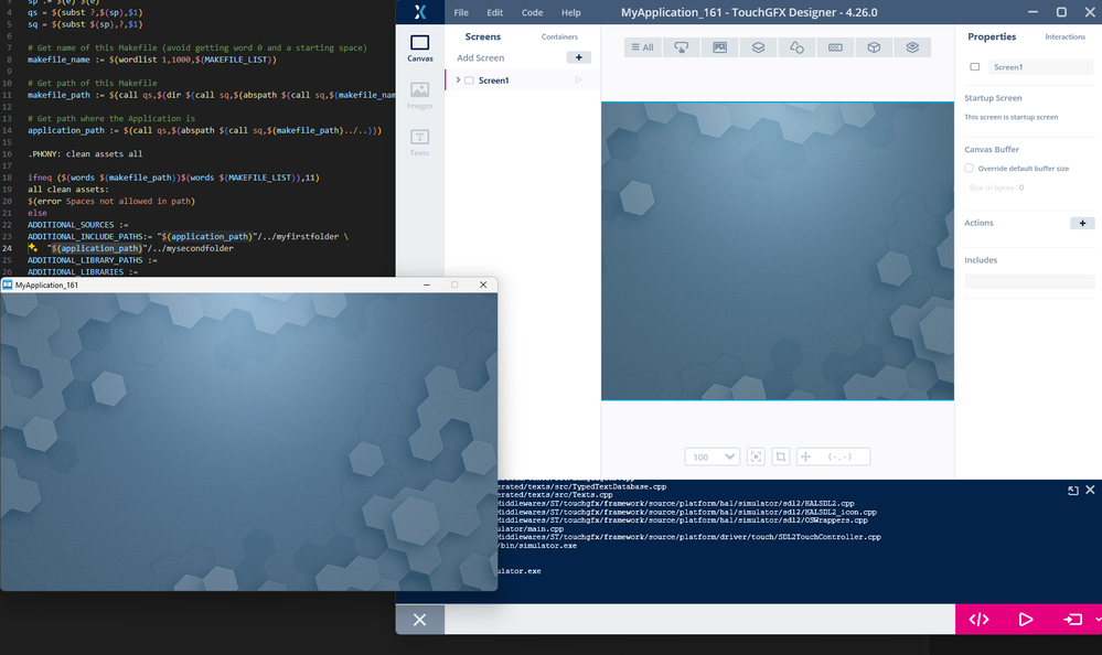

If i put the path in quotes, it works:

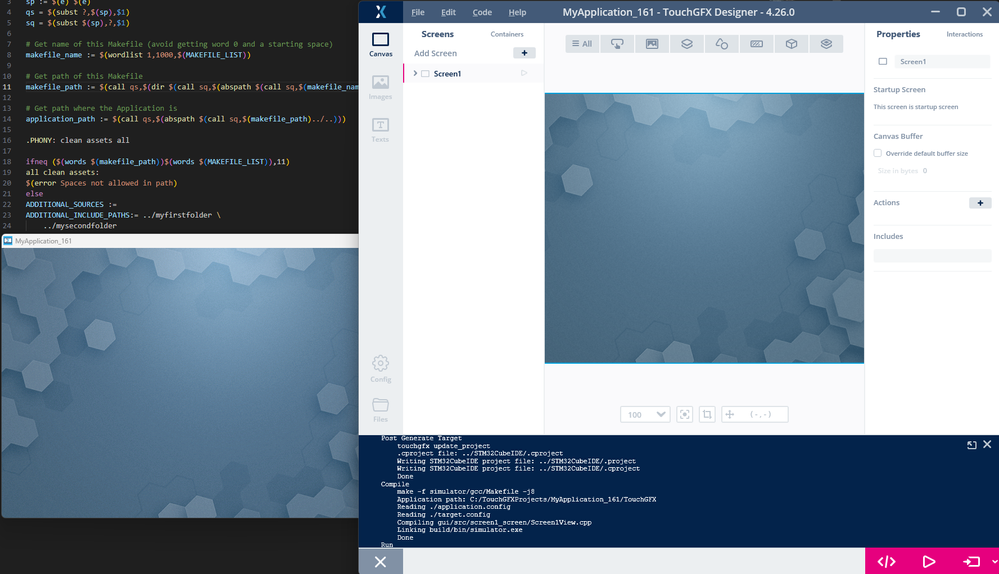

If I moved the folders to the root of the project to have a slash in the path without using a variable (../folder) it also works:
If I use the variable again, it still does not work, but it is enough to put the variable in quotes:

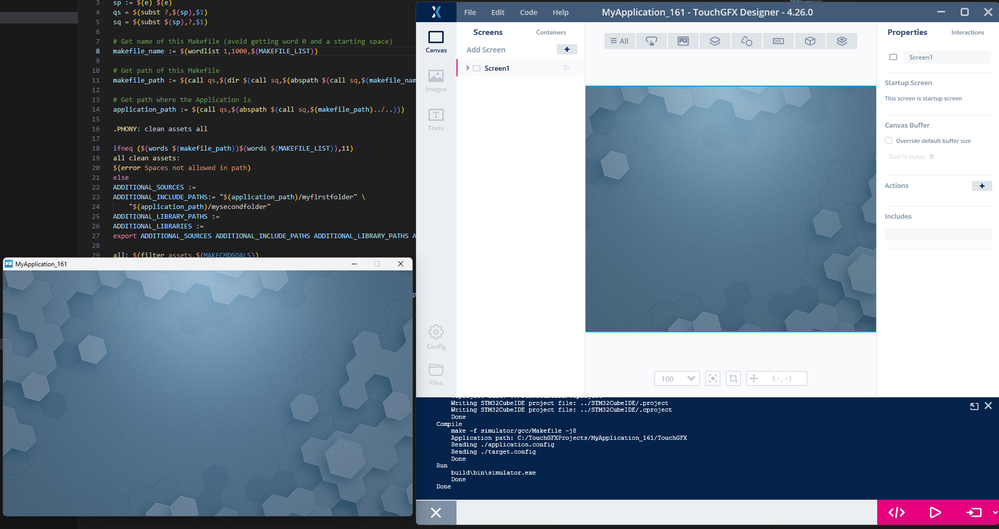

I've fiddled around with it a bit and also see the issue when using more than one path. It seems the paths are stripped for slashes (and backslashes), probably when the values are exported. For me it can be silved by putting the paths in quotes:
ADDITIONAL_INCLUDE_PATHS:= "$(application_path)/myfirstfolder" \
	"$(application_path)/mysecondfolder"
Can you try this?

Great work, I see the exact same as what you found, and everything works using quotations around the variable path. Thank you very much
