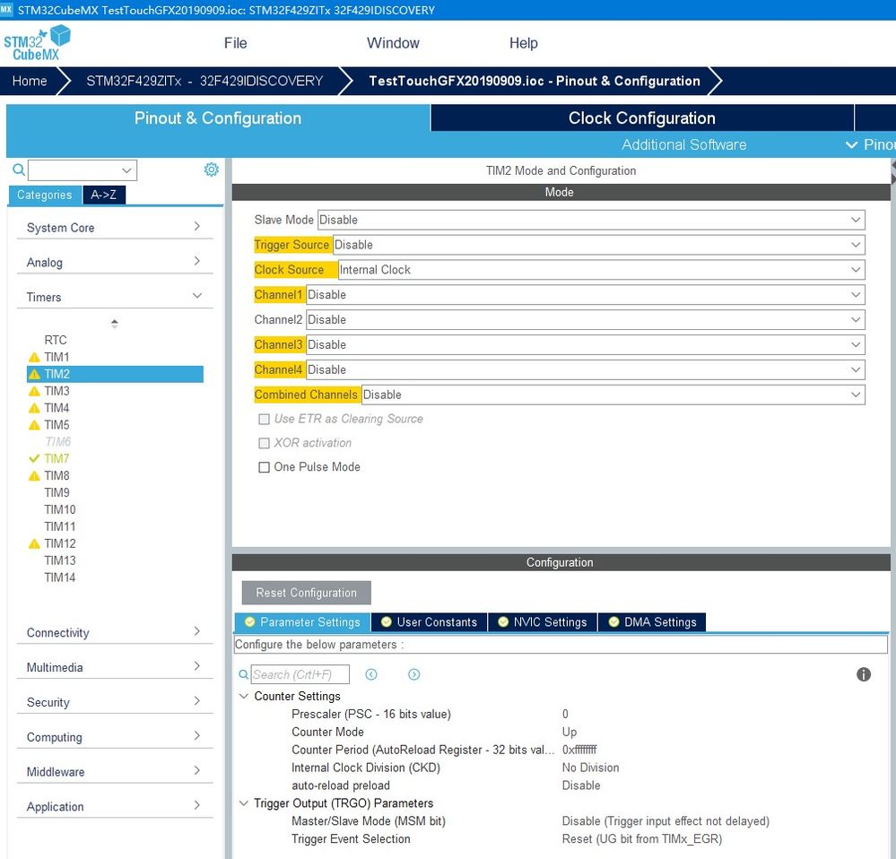

2019-09-19 7:34 AM
The Tim1 is 16-bit, The Tim2 is 32-bit.
So Timer selection Tim2.
In file STM32F4Instrumentation.cpp:
#include "stm32f4xx_hal.h"
#include "stm32f4xx_hal_tim.h"
#include <touchgfx/hal/HAL.hpp>
#include <STM32F4Instrumentation.hpp>
/* USER CODE BEGIN user includes */
/* USER CODE END user includes */
namespace touchgfx
static TIM_HandleTypeDef htim2;
void STM32F4Instrumentation::init()
RCC_ClkInitTypeDef clkconfig;
uint32_t uwTimclock, uwAPB1Prescaler = 0U;
uint32_t pFLatency;
__TIM2_CLK_ENABLE();
TIM_ClockConfigTypeDef sClockSourceConfig = {0};
TIM_MasterConfigTypeDef sMasterConfig = {0};
htim2.Instance = TIM2;
htim2.Init.Prescaler = 0;
htim2.Init.CounterMode = TIM_COUNTERMODE_UP;
htim2.Init.Period = 0xffffffff;
htim2.Init.ClockDivision = TIM_CLOCKDIVISION_DIV1;
htim2.Init.AutoReloadPreload = TIM_AUTORELOAD_PRELOAD_DISABLE;
if (HAL_TIM_Base_Init(&htim2) != HAL_OK)
Error_Handler( );
sClockSourceConfig.ClockSource = TIM_CLOCKSOURCE_INTERNAL;
if (HAL_TIM_ConfigClockSource(&htim2, &sClockSourceConfig) != HAL_OK)
Error_Handler( );
sMasterConfig.MasterOutputTrigger = TIM_TRGO_RESET;
sMasterConfig.MasterSlaveMode = TIM_MASTERSLAVEMODE_DISABLE;
if (HAL_TIMEx_MasterConfigSynchronization(&htim2, &sMasterConfig) != HAL_OK)
Error_Handler( );
/* Get clock configuration */
HAL_RCC_GetClockConfig(&clkconfig, &pFLatency);
/* TIM2 is on APB1 bus */
uwAPB1Prescaler = clkconfig.APB1CLKDivider;
if (uwAPB1Prescaler == RCC_HCLK_DIV1)
uwTimclock = HAL_RCC_GetPCLK1Freq();
else
uwTimclock = 2 * HAL_RCC_GetPCLK1Freq();
m_sysclkRatio = HAL_RCC_GetHCLKFreq() / uwTimclock;
HAL_TIM_Base_Start(&htim2);
//Board specific clockfrequency
unsigned int STM32F4Instrumentation::getElapsedUS(unsigned int start, unsigned int now, unsigned int clockfrequency)
return ((now - start) + (clockfrequency / 2)) / clockfrequency;
unsigned int STM32F4Instrumentation::getCPUCycles()
return __HAL_TIM_GET_COUNTER(&htim2) * m_sysclkRatio;
void STM32F4Instrumentation::setMCUActive(bool active)
if (active) //idle task sched out
cc_consumed += getCPUCycles() - cc_in;
else //idle task sched in
cc_in = getCPUCycles();
2019-09-19 7:42 AM
