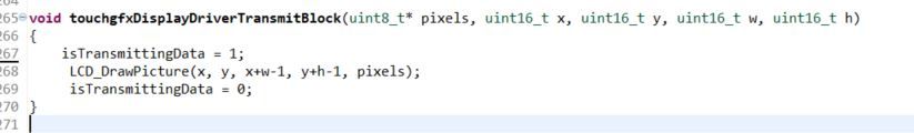

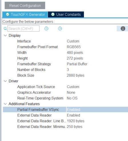

We are developing an application with TouchGFX using partial buffer method.
Here is our configuration.
our application has custom LCD support. The application reads data for LCD from external SPI flash and tries to send it to LCD.
Now the app calls "touchgfxDisplayDriverTransmitBlock" function where we have implemented calling LCD_Drawpicture routine.

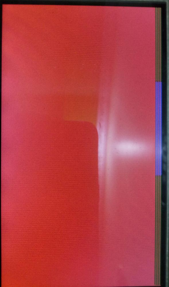

This function gets called and LCD_Drawpicture also works fine, however, we observed that this function always gets variable "h = 3" . Since h is always 3, we are only getting 3 rows on the screen as can be seen in the picture.
(Please ignore RED color, that is what we set in the LCD initialization to check LCD is working, using LCD library, before initializing touchGFX)

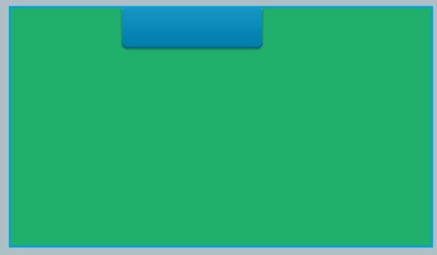

this is what we expect our application to show.

MM..1
Chief III
Your custom driver isnt complete and partial buffers read here Lowering Memory Usage with Partial Framebuffer | TouchGFX Documentation
