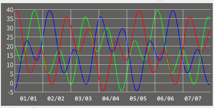

Frequently loading a Dynamic Graph or Static Graph will freeze TouchGFX's screen and render it inoperable.
‎2023-02-02 12:32 AM

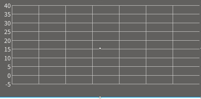

Frequently entering and exiting a screen with Graph in it, touchgfx will end up frozen on image2's screen and not fully loaded into image1's state.
Program run process:
xxxScreenViewbase::xxxScreenViewbase ---> xxxScreenView::xxxScreenView ---> xxxScreenPresenter::activate -x-> handleTickEvent --> Load Data to Graph
After the program runs to xxxScreenPresenter::ctivate no longer have any action.
Chip : STM32F29BI​
DataPoint Number : 420.
FrontendHeap::getInstance()::instance Address : 0x2002a334
FrontendHeap::getInstance()::instance Size : 20724 Byte
FreeRTOS : osThreadDef(touchgfxTask, Task_touchGFX, osPriorityNormal, 0, 0x4000);

Bugs appeared 30 times out of 1200 tests.
There was a BUG that would trigger when the screen was opened on startup.

Touchgfx updates the screen with chunking. When rect.y is 347 and 348, it is easy to trigger the screen freeze BUG.
