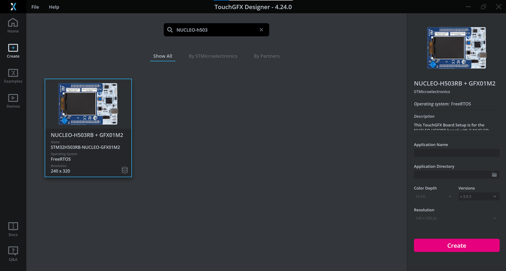

X-NUCLEO-GFX01M2 AZ1 Display Module uses the same display driver. Therefore, you can draw inspiration from the available TouchGFX Board Setups (TBSs) that use GFX01M2. For instance, you can take a look at the TBS for NUCLEO-H503RB or NUCLEO-G071RB
NUCLEO-H503RB + GFX01M2

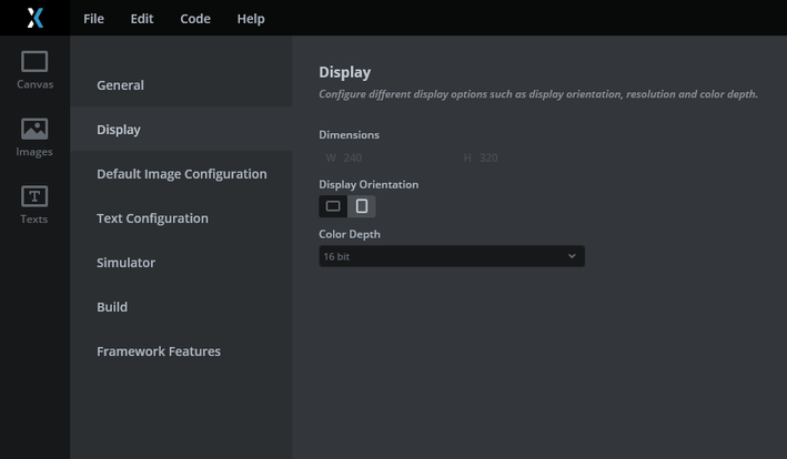

One thing that you should consider is your display rotation. Usually, the ST7789VI screen's default orientation is portrait, so you also need to configure your display as portrait, and based on the screenshot you've shared, it appears that your display is in landscape.
Display Orientation Settings
See if this change can help you!
2024-08-09 4:07 AM
Hi Mohammad. Thank you for your response. I've updated the orientationon TouchGFX before and in my display driver I have a rotation function that I use as well. It doesn't fix the issue though with the distortion and missing data.
