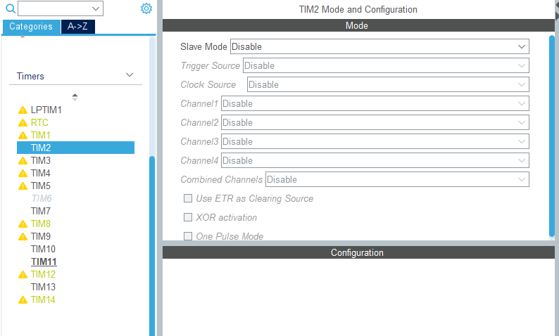

0690X00000ARJX0QAP.pngWhen I enable TouchGfx in Middleware->Graphics the Timer2 is being disabled (in ParameterSettings->TimerInstrumentation I select Timer14). Is there a connection between those two or it is a kind of bug I can fix manually in code?

​HI @kajoje123​ ,
Thanks for ypur feedback, this bug has been already fixed and it will be available for  the next release -5.4.0-

​Hello @kajoje123​ ,
Which CubeMX version did you use ?  Did you mean that you created  MX project from CubeIDE ?
could you please share your ioc file ?

Yes, I meant the MX project form CubeIDE
STM32CubeIDE - Version: 1.0.2 Build: 3566_20190716-0927 (UTC)
STM32CubeMX - Version: 5.3.0.201907110903
I created new STM32 Project - all the peripherals were initialized as default (STM32F746NG DISCO). Timer2 is being disabled when I enable the TouchGfx

​HI @kajoje123​ ,
