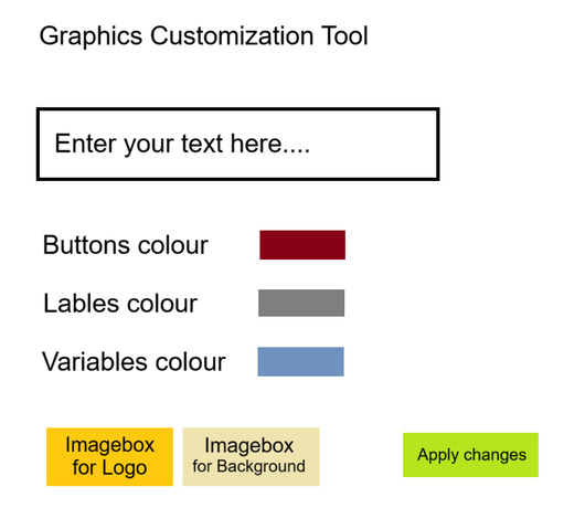

2- Colours: the challange is how to (select all) the texts and change the colour of them?
I have an idea which is to sort the texts into 3 groups as shown in the picture of the tool... because the only way to change the text colour is to change the colour of the text object itself and its not possible to change the colour of the whole resource or anything else thatswhy i think on creating a 3 arrays and each array represent a group of texts.
// The example may contain errors, only for explanation !
char ButtonColours[]={"textArea1", "textArea2", "textArea3"... };
char LablesColours[]={"textArea5", "textArea7", "textArea9"... };
char VariablesColours[]={"textArea12", "textArea20", "textArea22"... };
uint16_t ButtonColorRGB = unicode::touchgfx.getRGB(R, G, B);
uint16_t LablesColorRGB = unicode::touchgfx.getRGB(R, G, B);
uint16_t VariablesColorRGB = unicode::touchgfx.getRGB(R, G, B);
ButtonColours.setColor(ButtonColorRGB);
LablesColours.setColor(LablesColorRGB);
VariablesColours.setColor(VariablesColorRGB);
This way I think I could change the colour of the whole array, therefore all the text would change colour. What do you think? maybe there are code errors so please ignore that, i just wanted to explain my idea.
