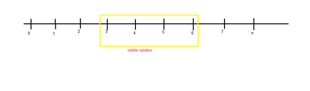

What is the best method to dynamically draw an axis with these graduations with label. For example, I want to display a range of 4 graduations out of 100 and be able to move the axis according to a value from my application.

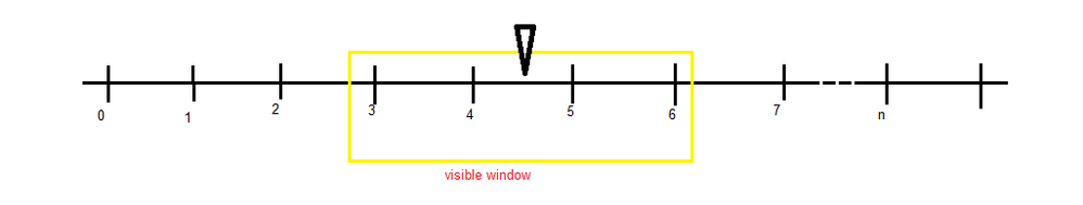

MFred.2
the objective is to graphically represent the position of a motorized carriage moving on a linear guide. so the position is dynamic. A fixed mark indicates the position relative to the moving axis (lines and label).
