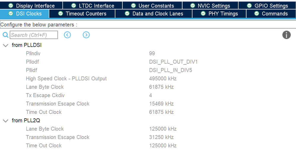

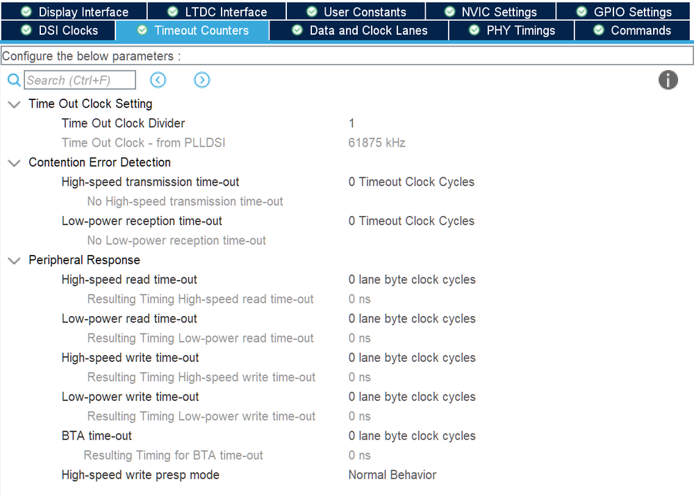

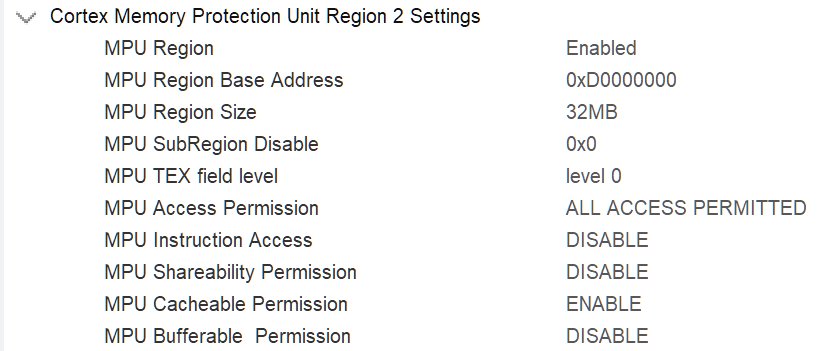

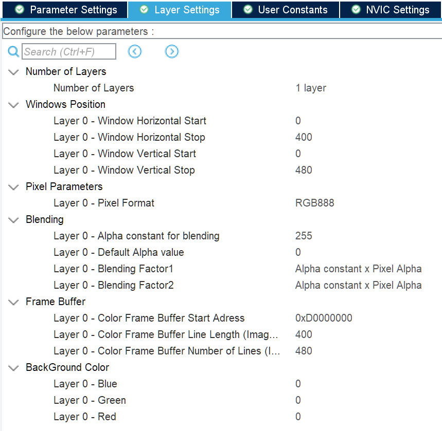

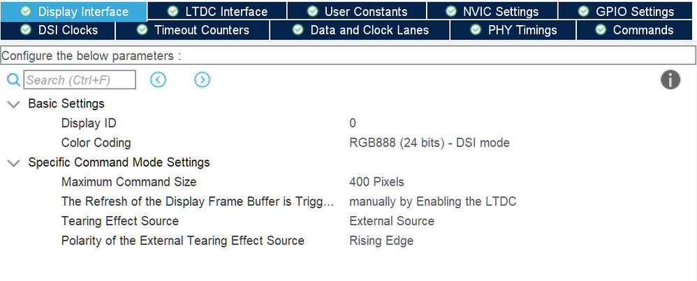

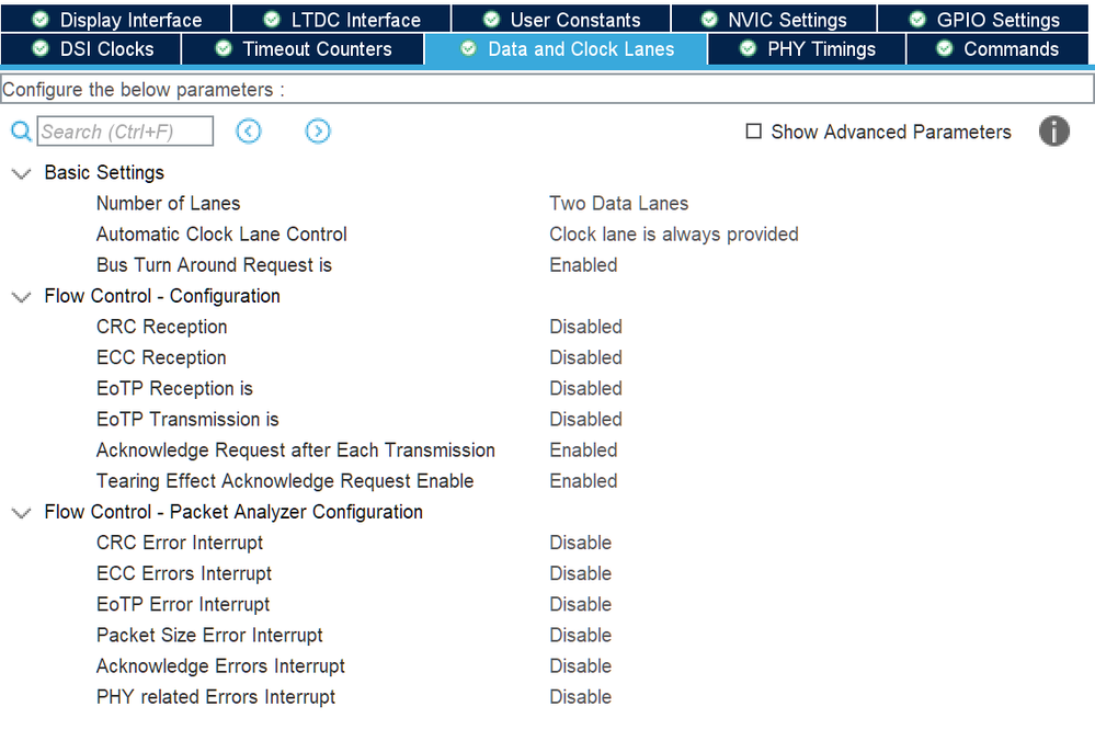

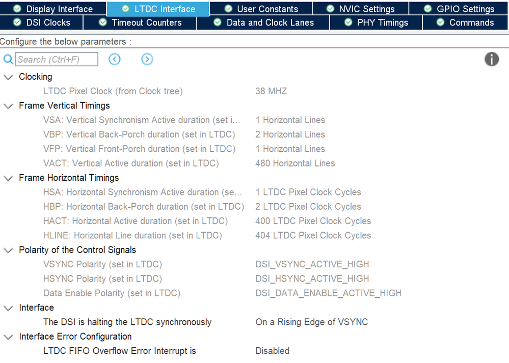

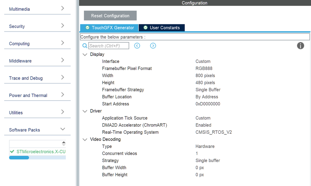

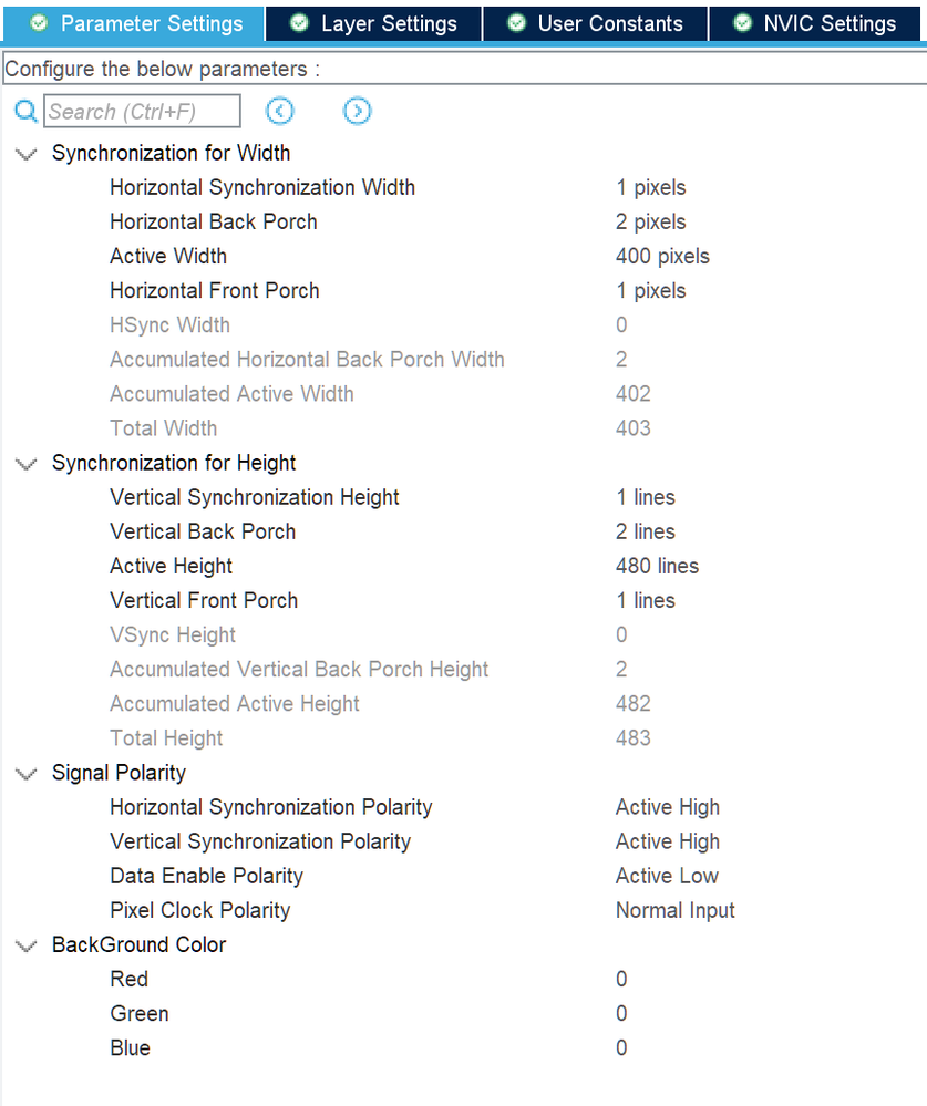

Of course, here it goes:
  • software pack configuration:
  • cortex M7 memory region protection:
  • LTDC parameters:
  • LTDC layer settings:
  • DSIHOST display interface
  • DSIHOST LTDC interfece
  • DSIHOST DSI clocks
  • DSIHOST timeout counters:
  • DSIHOST data and clock lanes
0693W00000NrWQxQAN.pngThe configuration presented is for single buffer, because when I switch to double buffer my application crashes.
My current code uses followin user code initialization:
    /* USER CODE BEGIN initialize step 2 */
    setAnimationStorage((void*)0xD0180000); // right after frame buffer, to enable slide transitions.
    HAL::getInstance()->setFrameRateCompensation(true); // to make slide transitions blazing fast.
    lockDMAToFrontPorch(false);
    mcuInstr.init();
    setMCUInstrumentation(&mcuInstr);
    enableMCULoadCalculation(true);
    /* USER CODE END initialize step 2 */
For double buffer I used address 0xD0300000 for the animation storage, 0xD0180000 was the second frame buffer address.

Hello HTD,
This TBS (TouchGFX Board Setup) is not prepared for double framebuffer actually. Unfortunately it's something that you won't be able to use, until we update this TBS. And I can't promise you something on it soon.

I've tested that it's not a matter of DCache issue on H7, but indeed it behaves differently with DCache disabled. With DCache enabled I got occasional garbage on the screen while downloading / connecting debugger, with DCache disabled the issue disappeared. From what I've read on H7 DCache enabled requires extra steps performed while using DMA and original HAL drivers (at least those provided with my board) don't do it, so the data corruption occurs.
