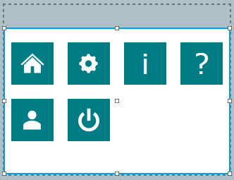

I have a CustomContainer (menuScreen) that opens when pressing the menu button on my taskbar.
In the MenuClickHandler function the menuScreen is added and the following container appears:
By pressing a button the screen is being changed. The problem is when pressing on the white background it could happen that an interaction is triggered (e.g. button pressed) from the screen behind this container.
How can I set the entire screen behind the container inactive or not touchable?
Is there maybe another solution?
Regards Dejan

I don't understand why setTouchable(false) doesn't work if you call that on the white background. Can you double check?
Or call setTouchable(false) on the buttons behind the container. When you show them (hide the container) set them touchable again.

unfortunately it did not work with setTouchable(false) on the white background.
To call setTouchable(false) on the buttons behind the container is a lot of work, because the menu container can be shown from every screen in this touchgfx project.
Maybe it is easier when the menu is a screen instead of a custom container. If there is no easy way to avoid the touch interactions behind this container it's the only solution to go.

We're missing something, or i am, because z-order is respected, and if you have something covering the entire canvas that is not clickable, then elements beneath it will not receive touch events.
Maybe it's easier if you send the project.
/Martin
2019-11-21 6:58 AM
I've send you the project in a message.
I've added the TaskBar container to every screen and in the TaskBar.cpp I add the MenuScreen container when the menu button is pressed.
Regards Dejan
