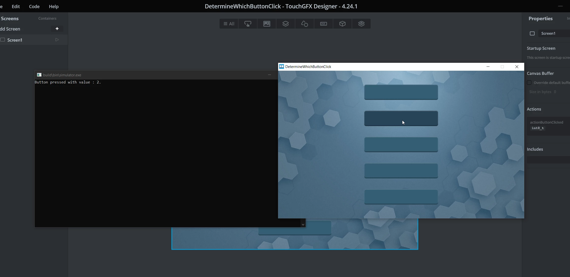

I have two buttons on Screen1.  Both interactions change screen to Screen2.
Can I determine which button was pressed when in Screen2View::setup?
Or do I need to use a separate virtual functions and then create a variable setting the button called?
Hello @FJB2069 ,
Here is a simple example with 5 buttons and interactions calling a same action that takes a value (from 1 to 5 based on the button pressed).
Note that you still have to create one interaction se choose the value you want to send when each button is clicked (for instance the buttons could be to add a product to a shopping cart in which case it should return the product ID).
Also, for such a simple example, it is even easier to directly print in the interaction created but I assume your final application is more complex.
Regards,
Gaetan Godart
Software engineer at ST (TouchGFX)

Hello @FJB2069 ,
Regarding your last message, it look like you have created 2 interactions :
  • one with button 10 as the trigger and the action is go to screen 2
  • one with button 1 as the trigger and the action is go to screen 2
This creates functions in the base file that cannot be modified by hand.
So instead, you could modify your 2 interactions so that the action is either "call new virtual function" or create an action (with a value of type int8) and call that action while specifying the button number. Then, on those 2 interactions, select "can trigger another interaction" and create 2 new interactions where the trigger is "another interaction is finished" and the action is to change to screen 2.
This way, you are able to call extra code (through the virtual function or through the action) before the screen changes.

Hello @FJB2069 ,
Regards,
Gaetan Godart
