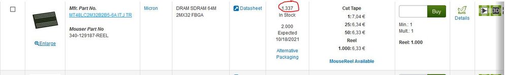

Would you please help pointing chips with exact pinout and specs if any as replacement for:
QSPI: MT25QL512ABB8ESF-0SIT
SDRAM: MT48LC4M32B2B5-6A IT_L TR
The External Loader is uninvolved with the SDRAM

hello
for SDRAM just different revision
Thank you @Vangelis Fortounas​ ,The only obvious difference as per the Datasheet is the memory size:
4 Meg x 32 (1 Meg x 32 x 4 banks), proposed replacement is 2 Meg x 32 (512K x 32 x 4 banks).
My main concern is the External Loader "MT25TL01G_STM32H750B-DISCO, 0x90000000, NOR_FLASH, MT25TL01G_STM32H750B-DISCO.stldr" provided by IDE, will it work with MT48LC2M32B2B5-6A IT:J TR?
Hello
From the same company MT48LC4M32B2B5-6A XIT:L is in stock in tray and also in tape reel
