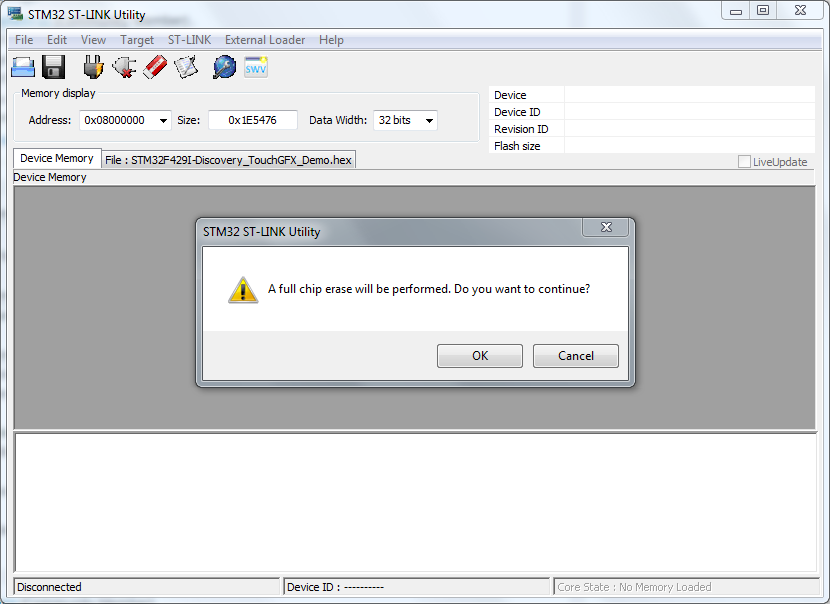

How about write zero to the graphic memory area immediately after SDRAM init?
Try a full Chip Erase and see if that helps.
