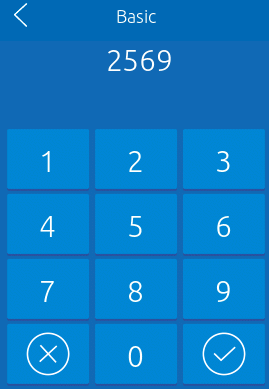

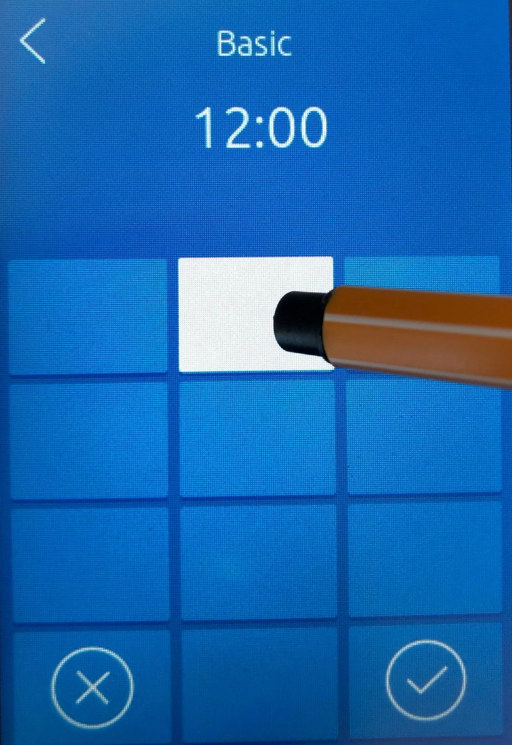

Hey there,
I have a strange problem with my custom keyboard.
In the simulator everything looks and works fine. See image:0693W000000WBUpQAO.bmp

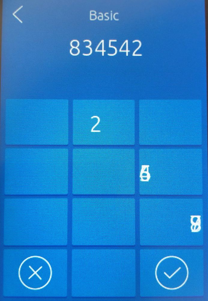

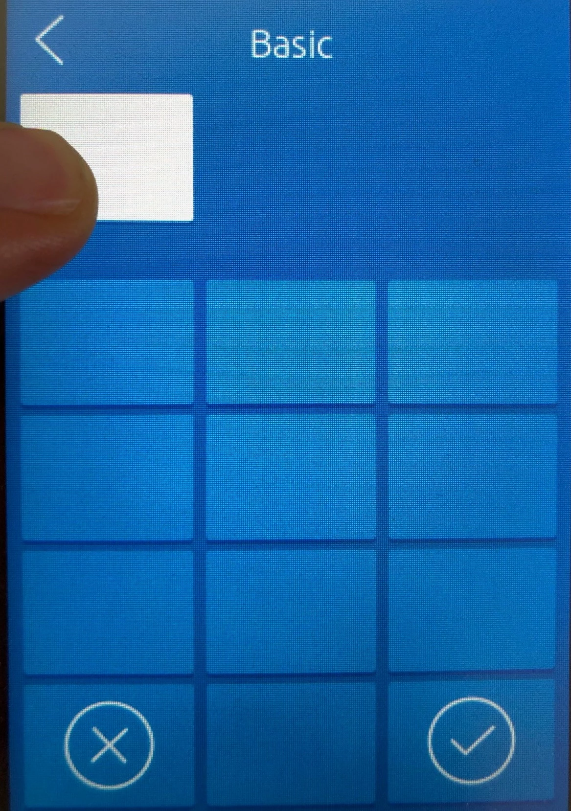

But when I download it to my target, following screen is presented:

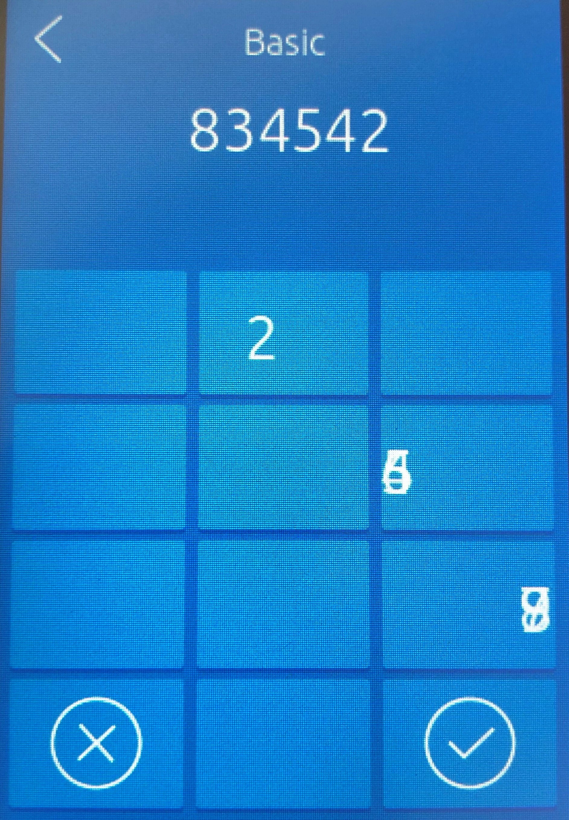

The touch events and the active rectangle are correct and the correct values are shown in the text area. See following image:0693W000000WBSpQAO.jpg

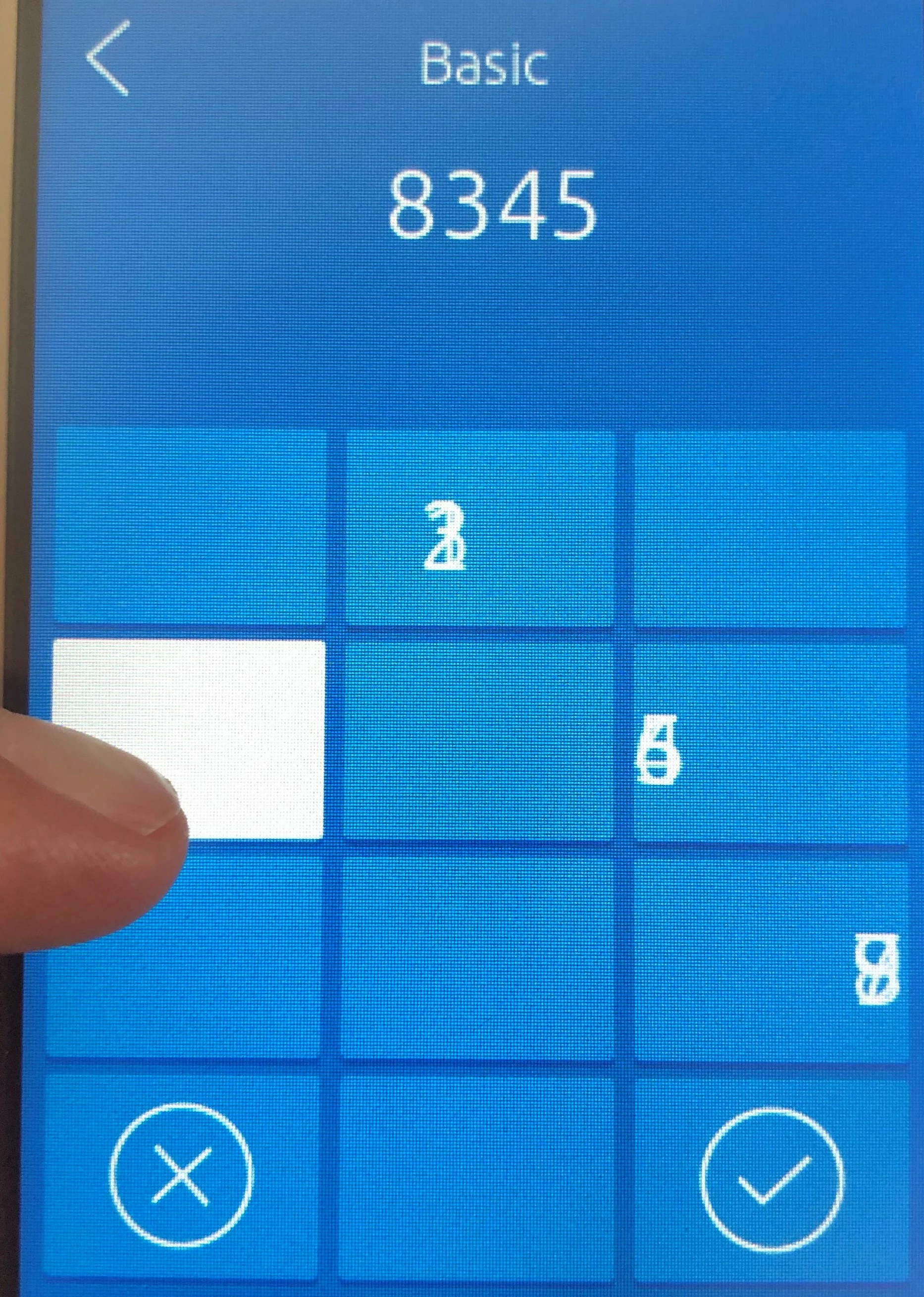

When touching e.g number 2, the overlapping numbers disappear. See:
There seems to be a problem with displaying the numbers, the overall functionality seems to work.
Any ideas what's happening here?

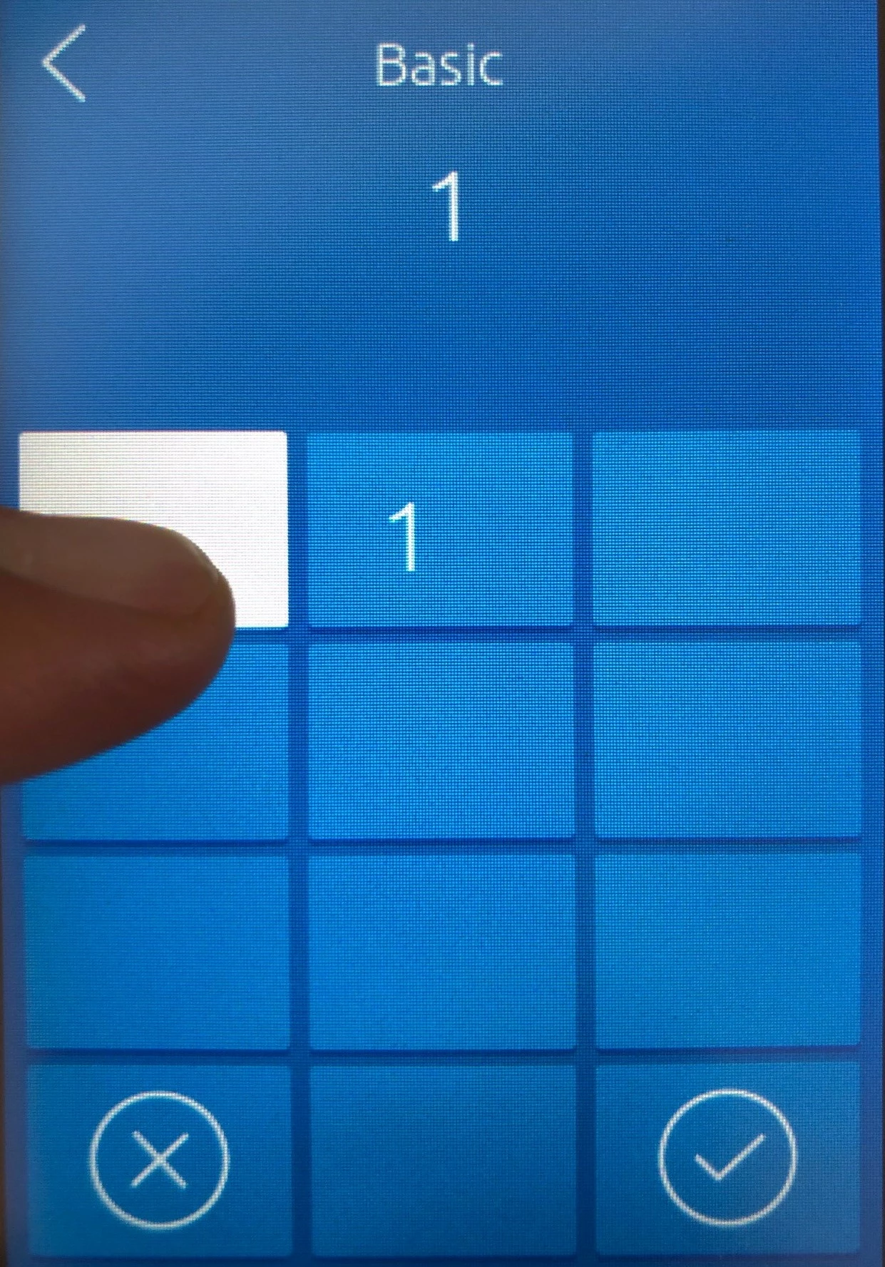

In the meantime I did some tests. I only displayed one digit to keep it simple.
With this code (Button coordinates 0/0)
static const Keyboard::Key keyArray[1] =
 { 1, Rect(0, 0, 82, 62), BITMAP_NUMERICKEYBOARDBUTTON_ID}
I get this (which is correct, the label is "underneath" the active button):

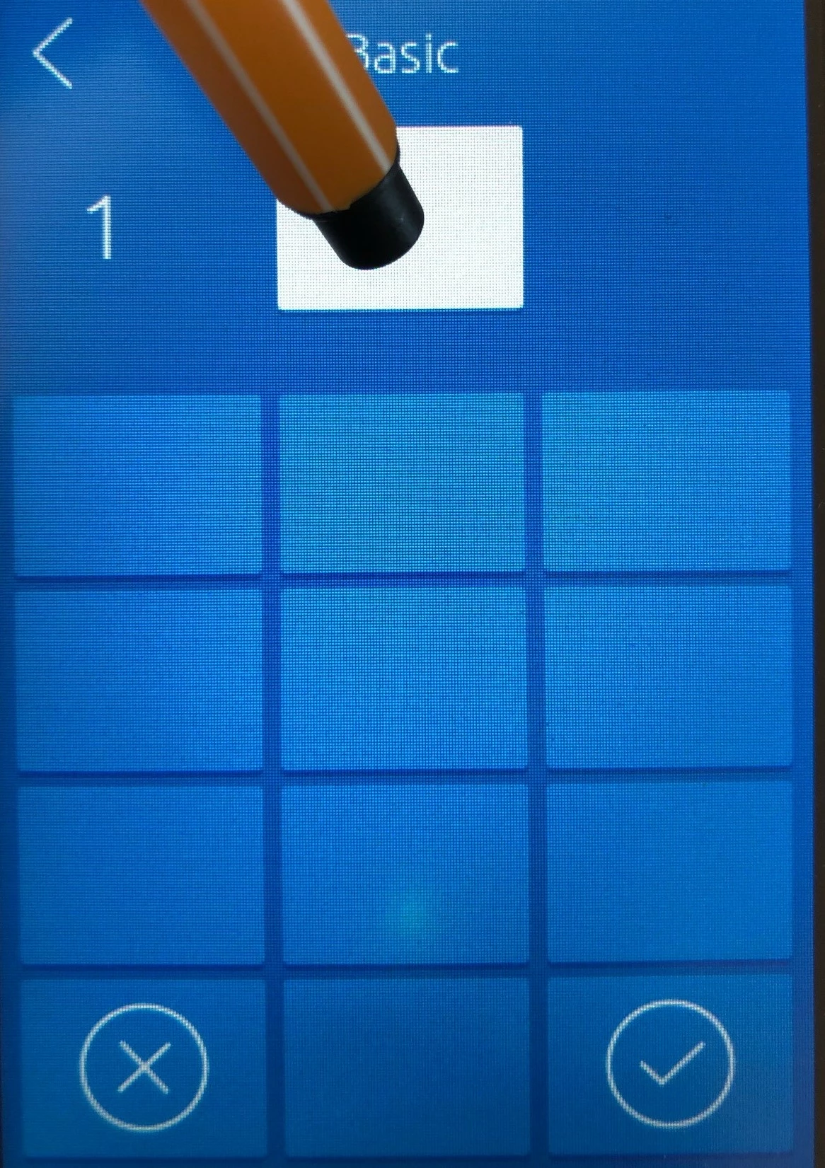

With coordinates (88/0):
 { 1, Rect(88, 0, 82, 62), BITMAP_NUMERICKEYBOARDBUTTON_ID}
I get: (Button moved correctly in x-position but the label is at the wrong position)

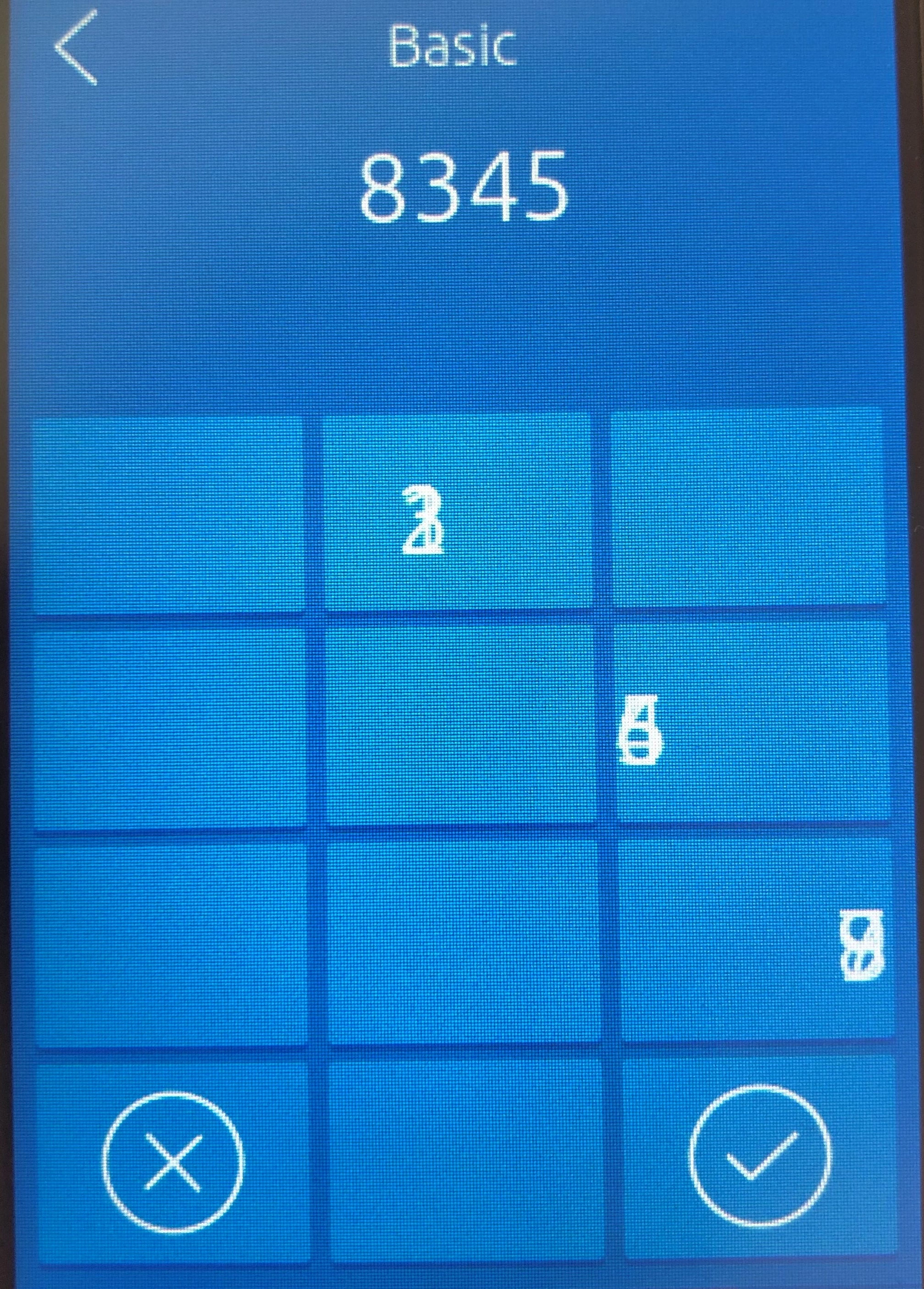

With coordinates (0/88):
 { 1, Rect(0, 88, 82, 62), BITMAP_NUMERICKEYBOARDBUTTON_ID}
Again, the button moved correctly in y-position, the label also moved but at the wrong position.
With coordinates (88/88):
 { 1, Rect(88, 88, 82, 62), BITMAP_NUMERICKEYBOARDBUTTON_ID}
The button and the label are at the correct position (label underneath the active button)
It seems as the label corrdinates are not translated correctly. I'm using the display in portrait mode. Is there a difference as how the simulator translates the coordinates in comparison to the "target" code?

jimmii
jimmiiAuthor
Senior II
May 6, 2020
Hello @Martin KJELDSEN​
Quick update:
I'm putting all RW and ZI data to external SDRAM, which works perfect for me and I didn't have any problems.
But the Keyboard causes problems with this configuration as described above.
After moving the Keybord Configuration to interal ram (RW and ZI) the Keyboard is working fine as expected.
Any idea why this is a problem? Maybe you can reproduce this behaviour at your end?
External sdram configuration and initialization is well tested and is working in other parts of the code.
/jimmii
