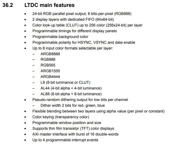

Could you please confirm if STM32H7A3RG supports RGB666, RGB888 to interface with 10inch TFT LCD display.
RSHAR.2
I am Reshma, based on my design requirements, my team has chosen STM32H7A3RG MCU . We want to confirm if this MCU will support, RGB565,RGB666, RGB888 display formats. Please find the attached high level block diagram for our requirement.

Hello @RSHAR.2​ and welcome to the STM32 Community :)
I advise you to refer to the RM0455 which provides information on the features of the STM32H7A3 peripherals.
0693W00000APkIQQA1.jpgThe application note AN4861 would be a very good guide for you to properly consider the best configuration and it's applicable for STM32H7A3 products.

RGB666 would be achieved via a simple truncation of the pins used for RGB888, and a suitable mapping into the 24-bit colour space of the video data.
