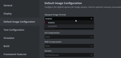

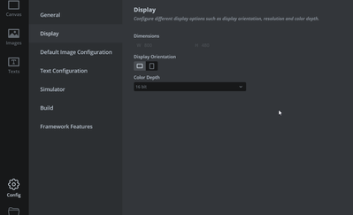

Hello @GMeur ,
When you say "the 'my-application-bis' project doesn't realise it's changed and keeps showing its equivalent in the 'asset' folder", you mean in the Images window in TouchGFX Designer? Or is it in the actual asset folder?
The issue seems to be that you would like to force to regenerate the assets, in that case, maybe you can try to change the display configuration like the color depth:
or the image format:
Regards,
2025-01-21 2:22 AM
Yeah, in the Images window of touchgfx. Because it keeps using the 'assets' folder instead of using the 'assets-2'. Same happens for the fonts too…
It's what I do for now, changing a configuration value to force it to regenerate all images but it's not ideal tbh.
