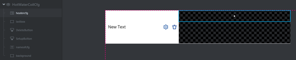

Is it possible to get callback on my view from custom container which is in another container? And how to do that?
I've tried to do like this. Create a callback for button:
Here goes when callback gets call. And I create an object of other class to call function:
And goes to this function:

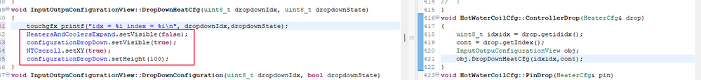

The problem with this method is that does not perform commands like "setXY" and etc. but only touchgfx_printf works. What I do wrong?

show code where you add create object Addnewzonebutton
2023-03-02 10:53 PM
Addnewzonebutton is in InputOutputConfigurationViewBase it is automatically created by touchgfx
2023-03-02 11:03 PM

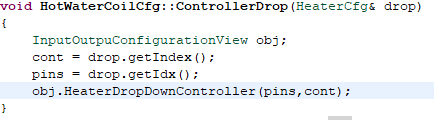

I don't understand why does not perform this function (marked in red)
Only prints text and when go through functions and do nothing. I just call function from another class and give them indexes

I've tried two methods. Pass index by pointer and by class.

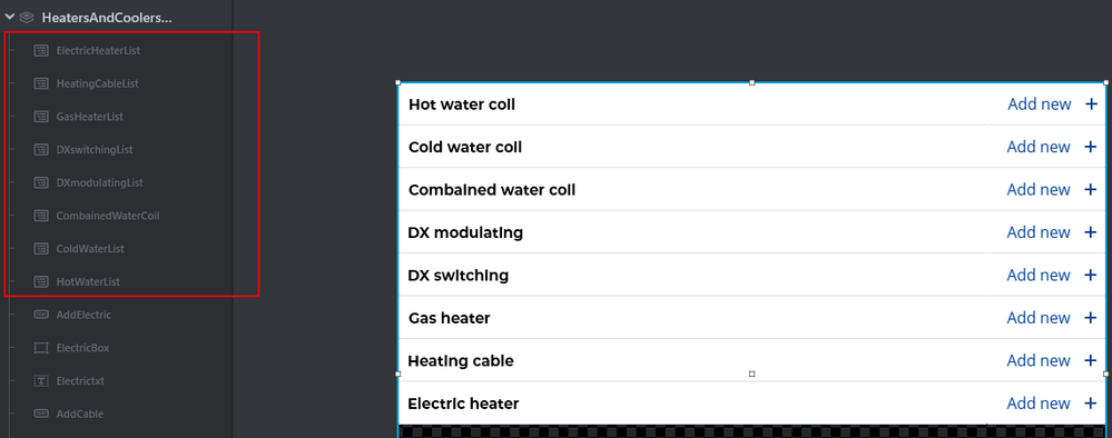

For better understanding what I want to do I try to explain. First of all in my view window is container and in that container I create a list using another container. On the left is my lists.

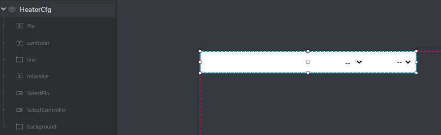

This is what I put in list and in this container I put another list:
So here is "SelectController" button and for that I create callback and by click I get index of that button:

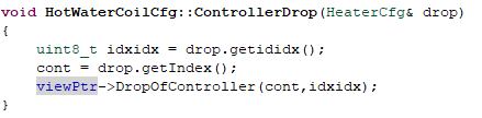

So I pass that index by pointer in HeatersAndCoolersConfiguration class

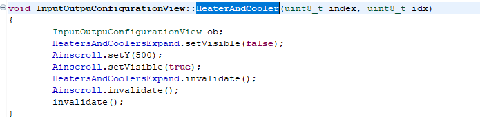

And this is my function in my view window:
Problem is that simulator crashes when I click SelectController button.
Another method that I tried to do pass index by function to call function in another class and it passes index but function like setY(), setVisible() does not work
