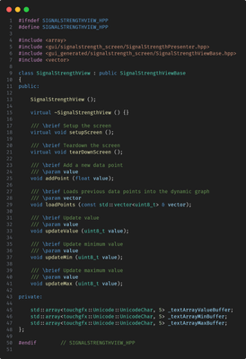

Extremely hard to read code! Why not consider some C++ annotation. This TouchGFX style isn't bad at all. I still can't understand your question. There are enough answers above that are a solution to your problem.
Consider an editor too: here's an example of what it looks like in VSCode:
