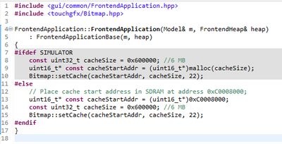

And i have created a 6MB cache in FrontedAplication.cpp which can print my image like 21 times.(I use the same image for debugging but later on they will have different images)

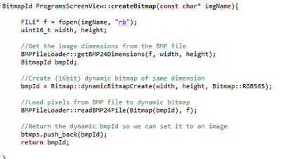

Hello @I_ve_got_a_problem ,
@JTP1 have mentioned to me that you are not closing your file after reading it.
I have tried to close it in the project you sent and it does solve the problem for me.
All I did was adding
fclose(f);
at the end of your createBitmap function.

This is a simulator project so i don't really know how I can enable or disable D-Cache, but until I declared this in the FrontedAplication.cpp the images wouldn't show, so it must be storing them in this cache:
Also if I try to print all of them i only see like 20-22 of the images, and if i reduce the cache declared in there it does show less images, so it's storing them there

Both this tests were done with 3MB declared in frontedAplication.cpp
      I tried the once every 25 ticks test but with 6MB and it crashed in 18 seconds too.
There is some concept that i'm missing here, because this suggests that the memory assigned in frontedAplication.cpp isn't doing anything at all, but if i coment whats inside it, no image appears, at all, which says that somehow it's storing them there in the first place.

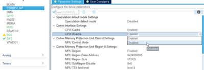

You can disable cache in the ioc file (STM32CubeMX) here :
I assumes you were using a H735 as you said you used this MCU in previous posts.

The createBitmap function just creates a dynamic bitmap and then returns its id.

The 43th call is having a problem, the 5 first image load work but the 6th fails.
I have tried updating only 6 images (inside updateList) at a time and by doing this, I was able to call the function 84 times successfully but fail at the 85th call.
So the 509th read always fails.
I figured that the size of the 509 call was wrong (value width and height in the getBMP24Dimensions function).
By manually changing those values to the pixel size of your image (240 x 240) I am not encountering any error anymore.
	width = 240;
	height = 240;
This is just a quick walk around that would work if all of your images are the same size.
