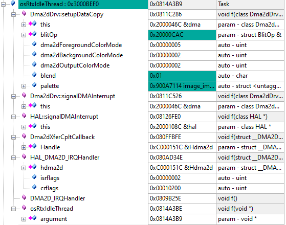

Hello
Just as an information; (@Alexandre RENOUX​ )
You added the function OSWrappers::taskYield() when using L8 images.
TaskYield() is called in the function setupDataCopy.
The problem: setupDataCopy is also called from ISR as you know, TaskYield() is not allowed to be called from ISR and you get Thread-Errors.
I think this should be fixed in the next release...
Cheers, Roman
For someone who is using KeilRTX, following function does the same for M3/M7 processors:
// Only call osThreadYield() when not in ISR Context
if((SCB->ICSR & SCB_ICSR_VECTACTIVE_Msk) == 0) {
	osThreadYield();

0693W00000BdFFEQA3.pngHi,
unfortunately I cannot share our project. I'm working on a custorm HW.
I attached the stack trace. Maybe it helps.
Please let me know if you need any more information.

I've been told 2 fixes you could try:
1) In OSWrappers.cpp change taskYield to only call osThreadYield if not in interrupt context, using this function:
portFORCE_INLINE static BaseType_t xPortIsInsideInterrupt( void )
2) Change setupDataCopy to not call yield if in interrupt context, or never call yield.
/Romain
For the time being I already went with option 2 without calling yield as with Keil RTX, Option 1 is not working as there is no such function.
So for now for me it's working...
	osThreadYield();

I'm using Keil RTX and I'm calling osThreadYield(); But the Keil "version" does not allow calling from ISR.
Perfect.
