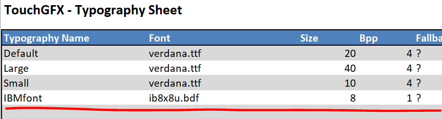

Documentation claims:
The Font Converter accepts
TrueType (.ttf)
OpenType (.otf)
Glyph Bitmap Distribution Format (.bdf).
I tried to use fonts from:
https://github.com/farsil/ibmfonts
I put fonts into folder: myproject\TouchGFX\assets\fonts
After restarting TouchGFX, IBM fonts do not appear into Typography list.
What is the problem?

‎2021-02-25 10:58 AM
The fonts might be available under another name (or weird name). A way to set it if you cannot find the name in the list would be to open the excel sheet in the assets/texts folder, and set the font you wish to use there. You need to not have TouchGFX open to be able to save the changes in the excel sheet.
/Romain

‎2021-02-26 4:30 AM
I tried the process I wrote above where you modify directly the font in the excel sheet. I then ran my project on target from CubeIDE and it works (I think, not 100% sure what the font I used from the git repo you shared looks like). However when I opened TouchGFX Designer I had a warning saying that the font was not found.
What I believe is happening is that, like for the OpenType format, TouchGFX handles the formats but TouchGFX Designer does not. You can still work on your GUI and generate code from TouchGFX Designer but will need to run on target from another tool.
/Romain

‎2021-03-02 7:10 AM
So I was actually able to use bdf fonts and display the text on my board (h7b3 disco), my mistake was that I did not set the bpp setting of the typography using the bdf font to 1... You also need to make sure you use the right size (so 8 for the font I used called ib8x8u.bdf).
The conclusion is that the font converter does work with bdf but the TouchGFX Designer tool does not handle this format. Like I wrote above you need to set the font for your typographie within the excel sheet found under the TouchGFX/assets/texts folder. (make sure you do not have the project in Designer open for that step otherwise you will not be able to save your changes)
After setting this, open Designer again and generate code even though the warnings are still there. You will not be able to run from Designer, you can use CubeIDE to do so ( or gcc, ewarm, keil).
I hope that it is enough for your project.
/Romain
